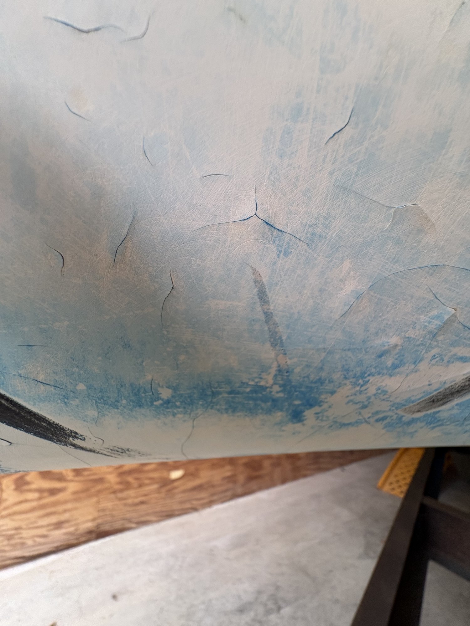

Whatever paint is on the bottom is ready to fall off. You'll need to sand it down, figure out what's underneath the white and then apply a compatible paint

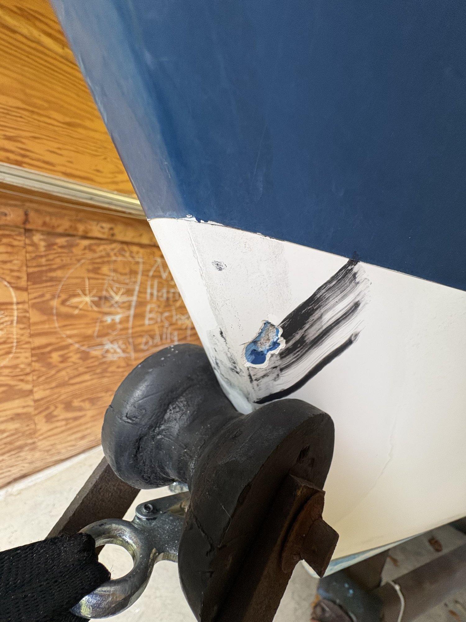

The bow damage will likely require some epoxy (TotalBoat performs the same as West Systems) and some gelcoat. Don't expect an exact gelcoat match

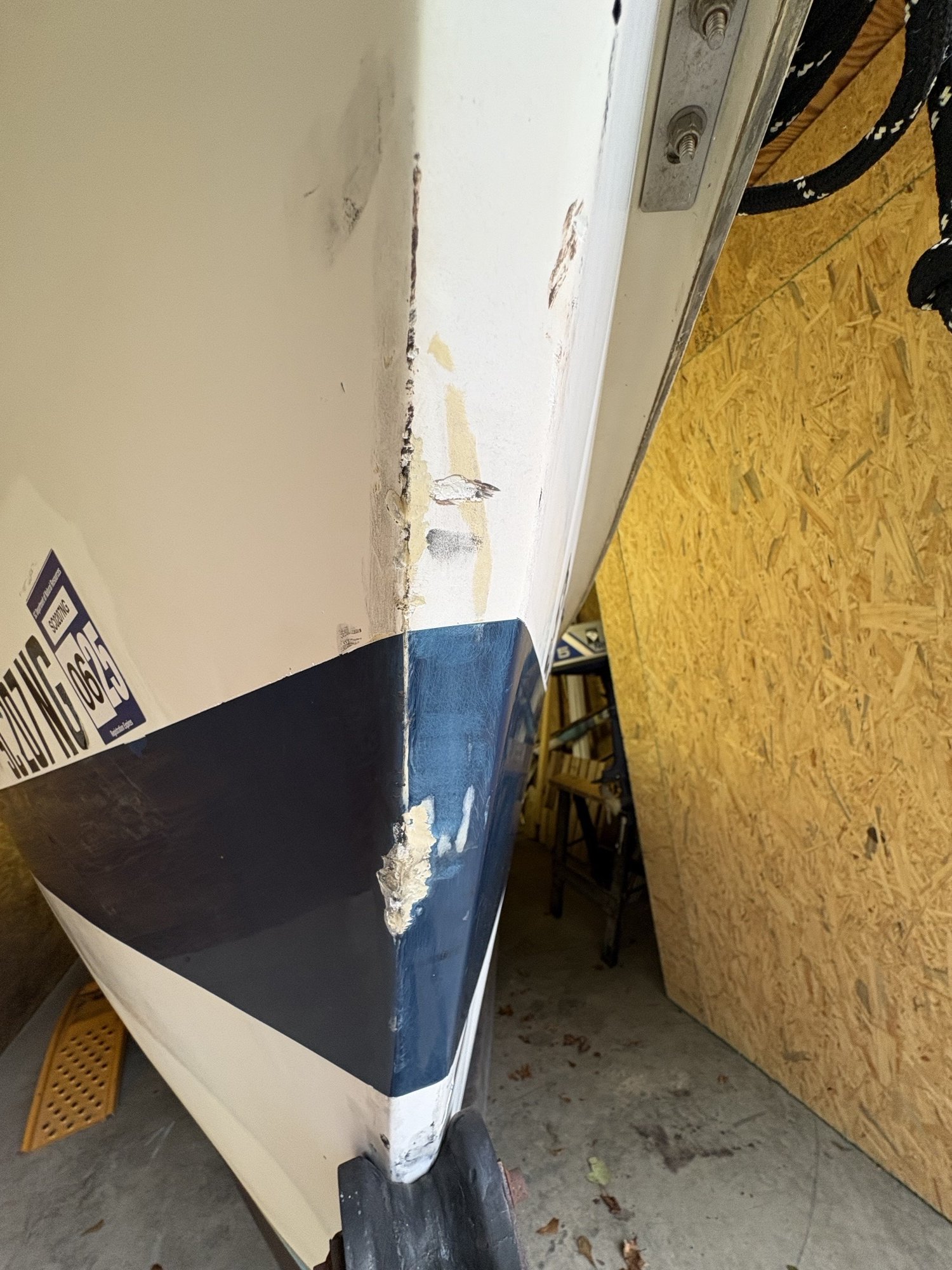

Thank you. I will give that a shot. Not too concerned about matching the gelcoat. At what point does damage like this require new fiberglass instead of epoxy?

Whatever is on the bottom needs to come off before any one can recommend a repair.
The bow looks to be mostly gelcoat damage with a little bit of damage to the glass. The glass looks like either Chopped Strand Mat (CSM) or chopper gun. Its primary purpose is to hide print through from the underlying layers of cloth making not really a structural issue. To repair those areas, sand the gelcoat and feather out the damage by about an inch or so from the exposed glass and fill in with gelcoat paste. Over fill damage a bit. Once it is cured, scrub the area with Dawn dish detergent to remove the wax that is in the gelcoat and wipe with some denatured alcohol. Polyester resins (gelcoat is polyester) do not cure if exposed to air, wax is added to seal the gelcoat. The was floats to the surface and seals it. Now the fun begins, start sanding the patch with successively finer sand paper ending with 1000 or higher wet sand paper. Try starting with 220 or 320. Finish with a rubbing compound and wax.

It would appear that the bow is damaged Gelcoat. I’d guess that coming in hot to the dock was the cause. If the underlying glass is sound you could put dab of epoxy to stabilize the underlying glass mat. Then use a fairing compound to smooth and shape the surface. Follow that with some color matching gelcoat and you good to go.
The bottom could be cracked paint, gelcoat that is split, or anyone’s guess. I would grind out the cracks and expose the problem to solid surface. Then assess what to do next.

The port side bow chip might qualify for a bit of thickened resin but unless you already have some laying around, I would just do gelcoat. The bow is one of the tougher parts of the boat. There isn't enough damage to have any ill effects, as long as you cover up the exposed fibers in a reasonable amount of time. As you can see on your boat, O'Day put blue gelcoat down before the white. It was the same on my 25. I'm not sure how it would affect color in the end.

Epoxy is not UV stable. If epoxy is used, it must be covered with paint or gelcoat. People will tell you that gelcoat can't go over epoxy, that just ain't so. With proper preparation gelcoat can go over epoxy.

Aqualung74....I would use Marine-Tex putty on the bow damage. The painted area looks like the paint is lifting off the hull. The bottom was probably painted and the mold wax was not cleaned off before painting. I would sand it down to the hull, dewax the area and repaint the hull with bottom paint. Good luck.

Chip off a piece of the fractured coating to see what's underneath and to get a better idea of the coating. Take some photos and show us. It could be a hard bottom paint, an epoxy barrier coat, gelcoat, or something else.
