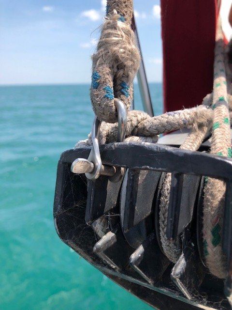

Here is a photo of how my topping lift attaches to the boom. Not sure what that little shackle is called...
My topping lift ties off at a cleat on the mast. It is not run back to the cockpit. I seldom move it (usually just when I set my winter cover over the boom...to tighten the cover a bit).

Greg / Tally Ho:
That's on you're post looks like it was intended for a much larger load than just a "little topping lift". Did the boat have a Dutchman or something else?

Sometimes, I've seen Oday's with little block on a shackle that attaches to the topping lift above the boom. Then a line runs up- to the topping lift and then down from the boom end. Then it runs through another block and along the boom to toward the goose neck. It's then adjustable from forward. Sometimes people have a roller furling main -- that's a different set-up requirement.
You can have a set-up like Greg showed, but then you have to go "up" to the masthead and then "down" toward the deck along the mast.
Again, what is the rest of your story? Pictures are worth a lot in helping....

I don’t think Tally Ho had a Dutchman. That shackle is not real heavy duty, but holds the boom up just fine.
Greg
I was wondering about the apparent diameter of the line. The shackle size seems a function of the boom end.
Not sure what diameter. About the same as my main halyard I think. Maybe a little lighter.

As Tally Ho says, my main halyard and topping lift are both 3/8". My end attachment is the same as Tally Ho - a small shackle. The factory rig is to take the topping lift from the end of the boom to the top of the mast, down the inside of the mast, exit 5' off the deck, and to a mast cleat, which is how I used it for 10 years. Recently , I have run the topping lift back to a port cabin top winch I recently installed. I do have to adjust the topping lift slightly, because I want to lift it up a few inches above my bimini when tied up, but release it those same few inches underway, so that close hauled the main has a nice tight closed shape (no twist) in light to moderate winds. If I did not have a bimini, it could stay the same place all season. I would not want less than 3/8" topping lift, unless it was dyneema.

If you have a small shackle you need to match the ultimate load with the weakest link. The load on the end of the boom when close hauled in a bunch of wind (with some shock loads added) might overwhelm the shackle.
You want the topping lift NOT to take "sheeted-in" loads and transfer them to the masthead. It's really ONLY INTENDED to keep the boom up if there is a release the of uplift on the main. This is usually, but not always, from you releasing the halyard to lower the main to stow or reef the mainsail. In some crazy jibe situation, strange things can happen too. God forbid that the main breaks and the topping lift keeps the clew end of the boom from braining someone....
If you use a 3/8" line, a braided Dacron or polyester line is MORE THAN enough. The issue with the line is really how easy it is for you to handle it. A little stretch is fine -- though I wouldn't use braided nylon. The reason I'd used a braided line is it holds less dirt, is easier on the hands, and it's more UV resistant.
