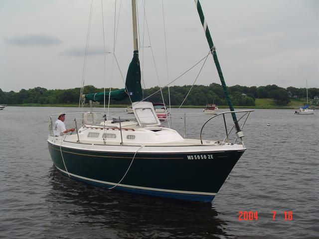

Lou,
I sailed a 1975 O'Day 25 for about 17 hours straight one day and I can tell you that this boat sails great. I'm not too keen on having the centerboard pendant line cable on the dinette table stanchion, but I think that I would overlook this if I wanted this boat. I don't think that it's that big of a deal except that I'm pretty sure that the metal cable can be swapped with a braid line according to Rudy Nickerson of D&R Marine. http://www.drmarine.com/ I'm not sure if it's possible to change the pendant line over so that it can be operated from out in the cockpit. I know that some people on this forum have brought it up from time to time and at least one guy was successful at doing it a few years ago using various sheaves to direct the line. You may be able to set it up so that you could reach inside the companionway hatch and work the centerboard. I think the Seaward 22 has this type of arrangement. To my way of thinking, that would be just as good as having the pendant line exit directly into the cockpit, similar to the later models. The 75 OD that I brought up from Cape Cod is owned by one of our SYC members and he loves this boat. I had her laying on her combing most of the time as I sailed her through Buzzard's Bay and Rhode Island Sound, and she handled as beautiful as my 86 O'Day 222. I can't say enough good things about this particular year and model O'Day 25. If you like this boat, look it over good and scoop it up. Here's a picture the I took of this boat, with courtesy of my friend Floyd.
