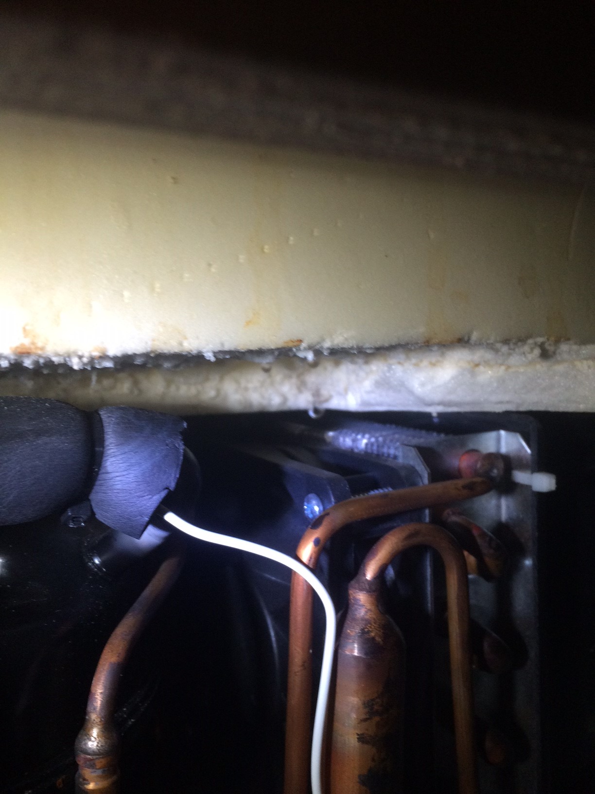

I bought my Beneteau Oceanis 48 new from Signature Yachts & have had issues with the freezer since day 1. They have replaced the thermostat twice & the compressor once. It now comes to light the freezer does not have enough insulation and in fact they shaved some of the insulation off the bottom of the freezer to make the compressor fit. Now in order to "try" to keep things frozen it has to run almost nonstop which also makes the outside of the box sweat causing a build up of moisture in the area that is causing other issues. Signature is not standing behind this issue & tells me I am using the boat harder than it was designed, i.e. more than a few weeks during the summer & the occasional weekend. Has anyone else run into this issue? I'm told my only options at this point is to redesign the area & move the compressor out & add more insulation myself which on a new boat seems crazy.
