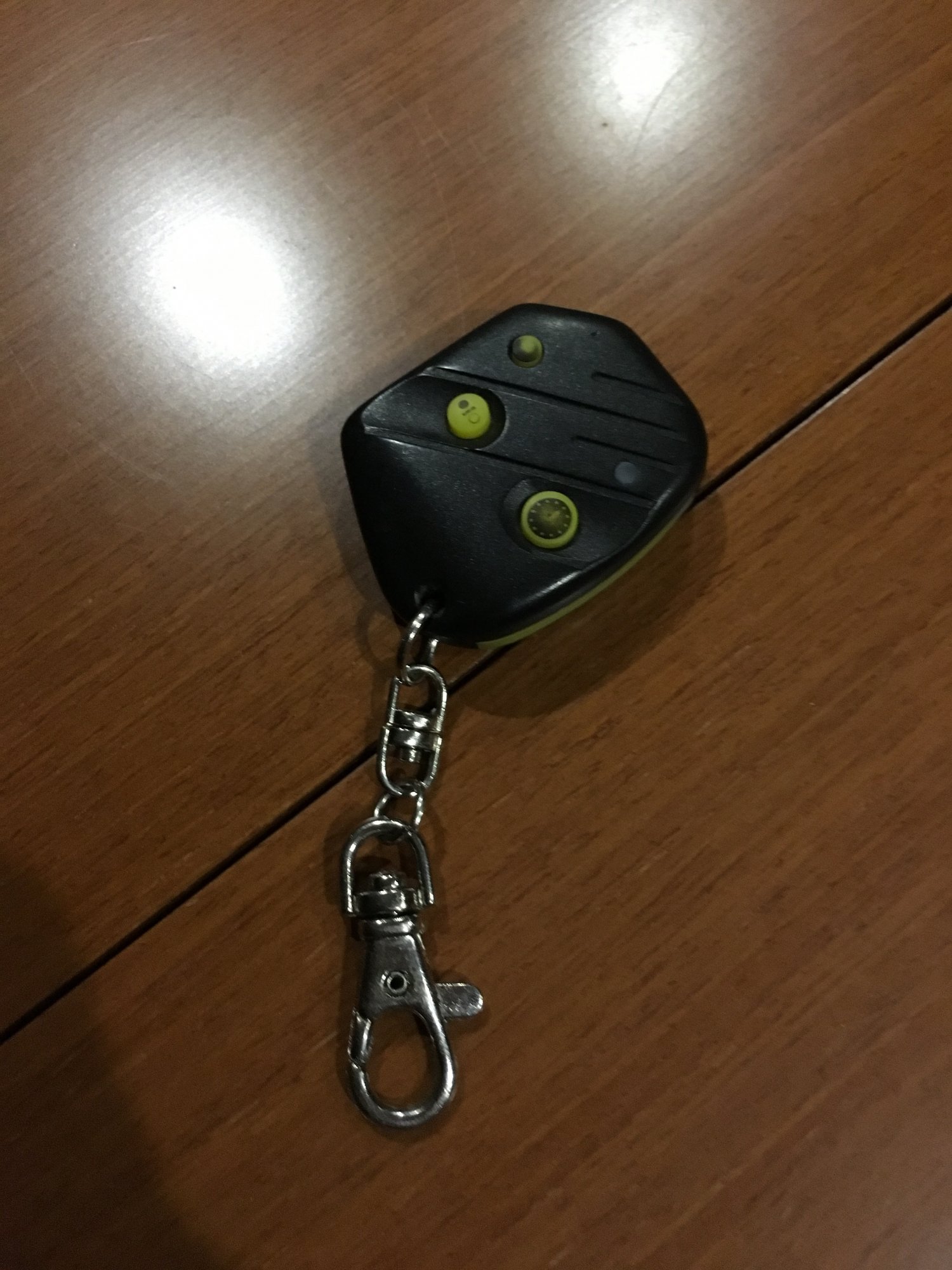

On our Beneteau the cockpit floor lights are remote controlled. Do you have a key fob remote that looks like this -

Man, thanks so much! It's so weird to me that they would make these remote controlled. I guess they are boarding lights or something..... That also explains the control box with antenna located in the starboard battery box I couldn't quite figure out. Unfortunately, I do not have the remote. I'll have to determine if it's worth researching availablity or just re-wiring the lights to be switch operated. Thanks again!
May 17, 2004
5,928
Yeah, I think so. One of the buttons on the remote is a timer, so you could have them on when you’re closing up the boat and turn off a few minutes later.
Exactly. A little black box in our case.

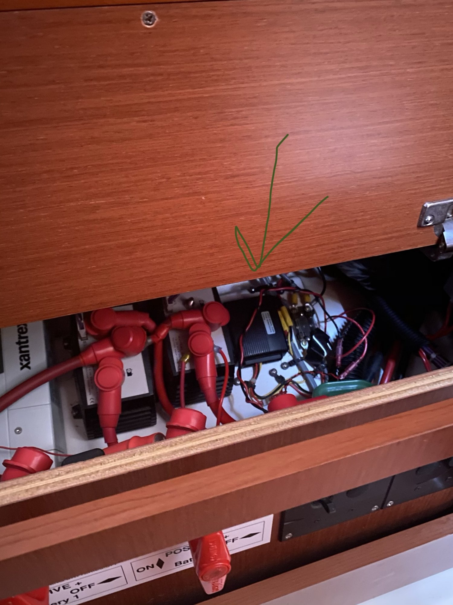

Dug around last night and the wireless control unit is made by Aqua Signal. Found a few links to the FOB online including West Marine but most appear unavailable for purchase.
