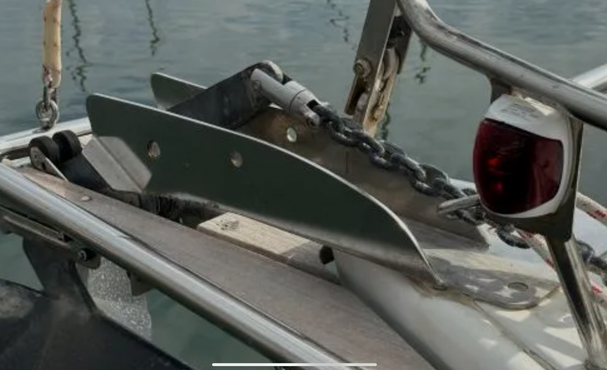

I didn't not own this boat. I am on the search for one in the 12-13m range. Oceanis 43 is one of the biggest options for me. On Photos it seems there is a second roller attachment behind the first one, and also enough space to cut 12cm... i hope to finde someone her with this boat. Thank you all for your Feedback!
