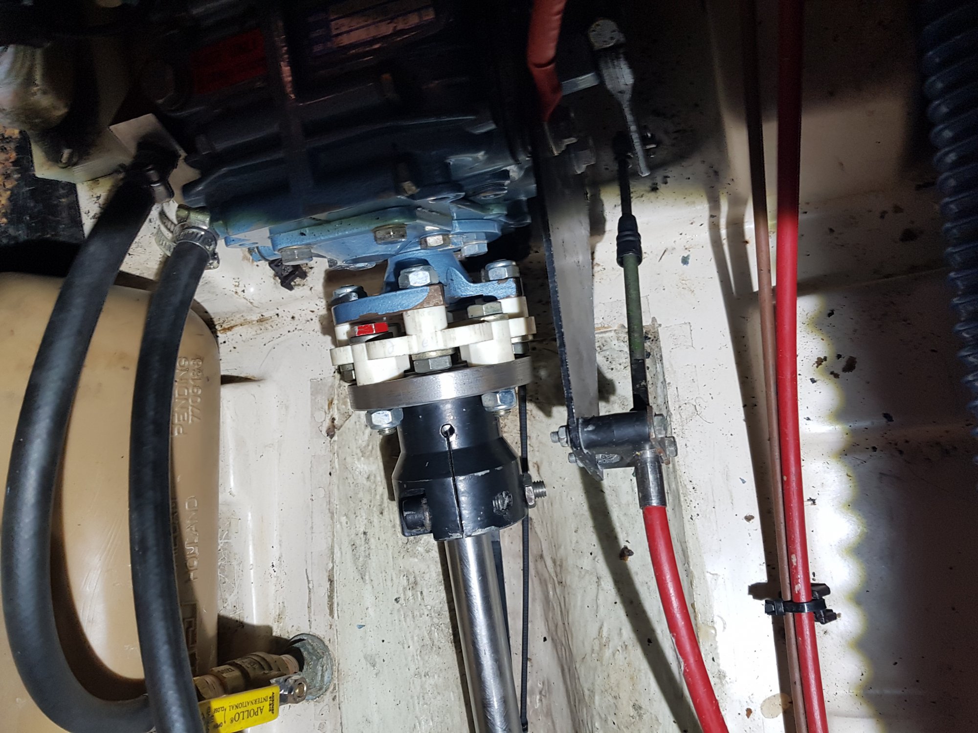

When i did mine there was wear on the prop shaft where seal sat so I added an R&D coupling moving it back 1.2 inches and allowing a bigger anode on shaft. I also machined a 25 mm delrin plug that went into tube centering the shaft . The engine was then aligned to shaft and it was out like 1/8 inch. Removed plug installed seal that was 3 years ago and not one drop

I have the plug in my nav desk will be going down tomorrow after work and will post measurement. .15mm is about .006 thousands runout ...too much no more than .003 TIR . I have done tons of coupling shafts and alignment as a Millwright for 40 years and .003 TIR is max and I shoot for no more than .001.I pulled my shaft dialed it .000 TIR installed the coupling and had to add another 2 setscrews in the coupling low side to get .001. I then machined across the facemaking it .000
If you look at my picture of R&D coulping you will see a red bolt this is to insert a feeler gauge at 12, 3,6 and 9 o'clock position to verify alignment of engine or adjust engine without coupling shaft unbolting
