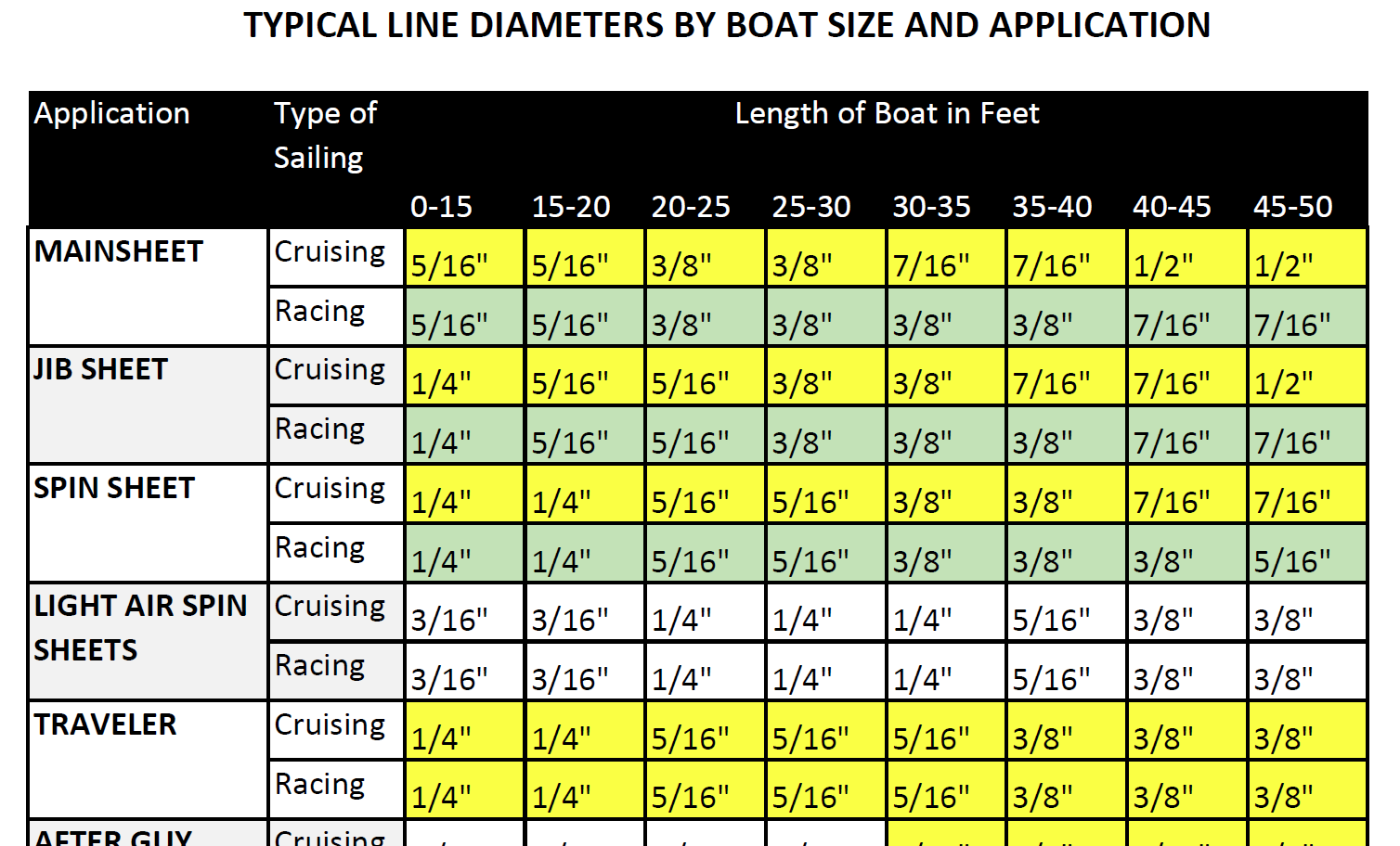

There are some rough estimates for all lines.
Here is an interesting site.

Thanks for all the information!
The line information is really interesting.
The sizes are much different than what is currently on the boat. Currently, the Main 15mm (5/8) in diameter. Would that be because of the older lines?

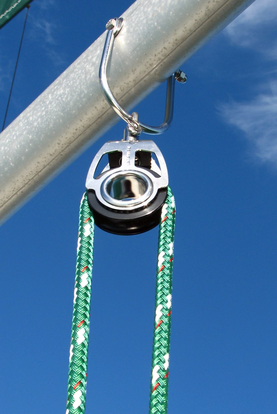

Here is an image of a block where the line is a little larger than the sheave width. The blocks open structure lets the boat owner get away with the larger line (line rides above the edges of the block not in the groove. On a sheave in the mast head it would eventually give chafe and friction problems.
