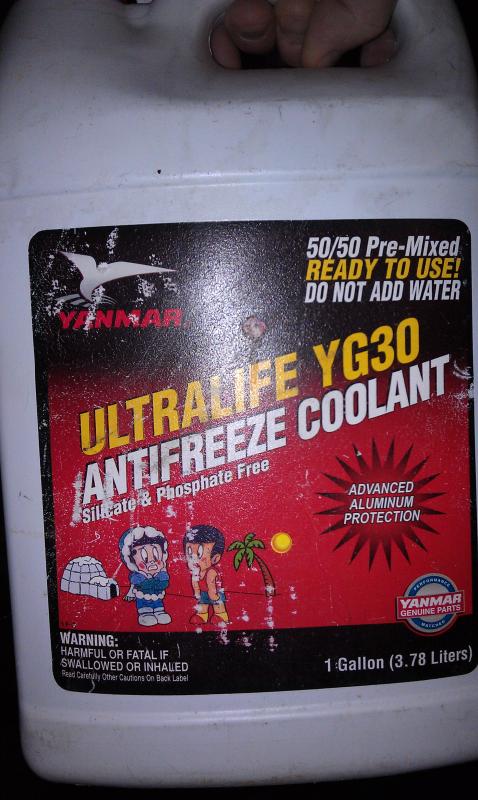

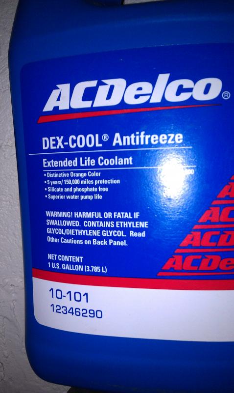

I use AC DELCO DEX-COOL and I cut 50/50 with water. its the orange/red color..the yanmar brand is the same orange/ red color.. I never buy premix, its not bad, but you get more bang for your buck buying straight uncut and mixing yourself. the yanmar jug was left on the boat when I bought it, I just use it to make the 50/50 mix.
Thanx for the info and photos. May I ask a couple
questions
1. Is your engine model 3gm30f ?
2. Do you use normal tapwater ?
3 is the AC DELCO DEX-COOL designed for Yanmar ?
