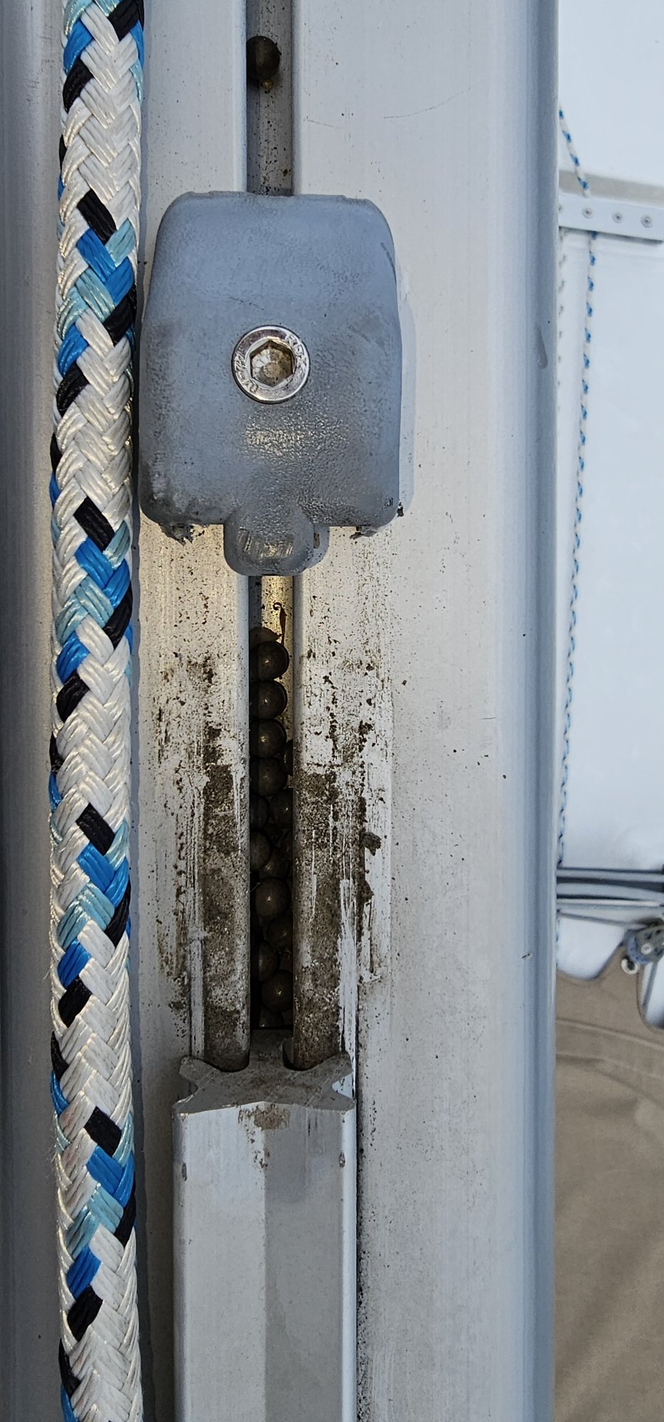

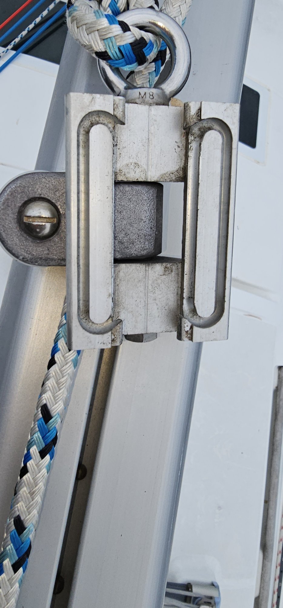

Need help fixing a Beneteau Oceanis 343 In Mast furlinh boom assembly. Was not rigged properly at the shop. At first winching the main the boom track and slider seperated and all the bearings fell out. Guidance on reassembling the whole sytem, as well removal of old bearing in the boom and add new ones (need the size and material and count) is greatly appreciated

Appears to be a US Spars make
Yes! I suggest contacting US Spars for advice on how to repair and for any replacement parts required. I have dealt with them in past and they offer sound advice and have oem parts available. When you contact them, you should ask about the boom outhaul car, specifically.
