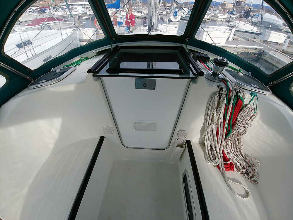

You definitely want 1/2" light smokey acrylic rather than wood. Privacy and lets in lots of light. If you've got access to a wood working shop, you've got it made. Make it into three boards for easier storage.
Acrylic is not difficult to work, just keep the speed high, the tools sharp, and the pressure low. All tools should be carbide. Nice to router the bottom and top edges to 45 deg. to keep the rain out. Also can be planed with reeeeeealy sharp blade on the 1/2" edge.

my 2006 323 has the acrylic. Did you look at the B parts site to see if there are acrylic panels for the 321?

Okay, so it is 95 on my balcony and 103 in the car. But I figured I'd do one for the Gipper and go to the boat to measure the crib boards. Nex time I'll take my boat keys so I can open the hatch. In spite of the brain melt, the top board is 24 wide. the bottom of the lower board is 19.25. overall height is 25 5/8 H. Of course the boards are tapered . I suppose the new boards would be drilled for the lock, or maybe even have a lock installed. OKAY, BACK TO YOU, FRED.

We replaced our cabin door with StarBoard from Industrial Plastics. While we were at it, we replaced all the other exterior wood with Quadrant_GP-POM plastic. Industrial Plastics ripped the round material into half-rounds for us. It's all very strong and no more maintenance required.

I like the idea and the material sounds like it could be the right product. we have a good plastic shop here in town and it's a little warm outside so that may be a better way of going about it just bringing them the hatches and have them cut to fit. I really like the pictures.
