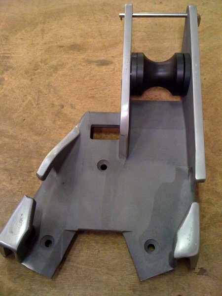

I have a friend who had the misfortune of hitting a dock severely last summer. The head-on impact was so hard that it broke the bow pulpit to which the anchor roller is attached. The anchor roller itself is stainless but the broken part, which forms the bow to which the stainless anchor roller is attached to, is made cast aluminum according to a welder to whom we showed the broken piece. According to the welder, removing the remaining part to weld both of them back together would not proove good enough and would likely break again. Looks like a complete new part is needed. So far calls to the Beneteau dealer in our area have not brought any info as to the availability or price. Boat is 1997 Beneteau Oceanis 321. If anyone has info on part number or availability of new or even 2nd hand parts, thanks for sharing.
Dec 14, 2003
1,443
Thanks. It does look similar but the cast aluminum section seems smaller than when I last saw the broken one. I'll send the picture to my friend for comparison with his pictures and the broken piece which he has at home (boat in on the ground and covered for winter). Will also try to get info from Beneteau USA.

Tks Re the Klacko info. At this point, looking at the picture provided by mdibella and comparing with what was originally on the boat it looks very similar. The original pulpit was redone to allow installation of a swivel channel to let the anchor go down by itself when the down button is pushed. It goes down carried by its own weight without having to go forward and push it. The channel allowing this was saved and will be re-installed once the pulpit is fixed. My friend and I are going to the boat this week and will take precise measurements with the broken part and the remaining one. Boat is under tarp for the winter but if we can remove the remaining piece we'll do so and thus be able to make a picture + have accurate measurement. BTW, I tried to go the the Beneteau USA site and it wants me to create an account before I can access the parts file. I will wait until December when I get to our winter place in Florida so I can provide a US address. Thanks for the help

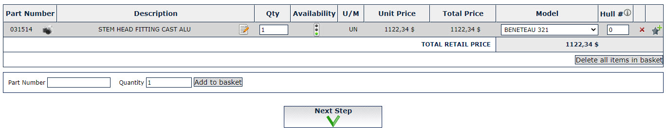

Since you haven't logged into the Parts System, here is the price and it looks like it is available.
Dec 14, 2003
1,443
Since you haven't logged into the Parts System, here is the price and it looks like it is available.View attachment 200332
Thanks Joker 460. That does confirm that the part 031514 as per the picture posted by mdibella is indeed the part my friend needs. We'll be able to double-check once we have been to the boat this week and then also check with Klacko. Thanks for the info
Dec 14, 2003
1,443
Went to my friend's boat yesterday and removed the broken part of the stem head fitting. Glad to find out that the info provided by mdibella and joker460 is indeed the correct part for the Beneteau 321. P/N 031514 is clearly stamped underneat the removed broken part. With that in hand we contacted the Beneteau dealer here in the Montreal area and they advised us that is is available at Beneteau USA and gave us the same price as provided by joker460. Of course they promptly told us the $1122.34 is US $ and also figured out the Canadian $ with the exchange added on. Which is fair.
