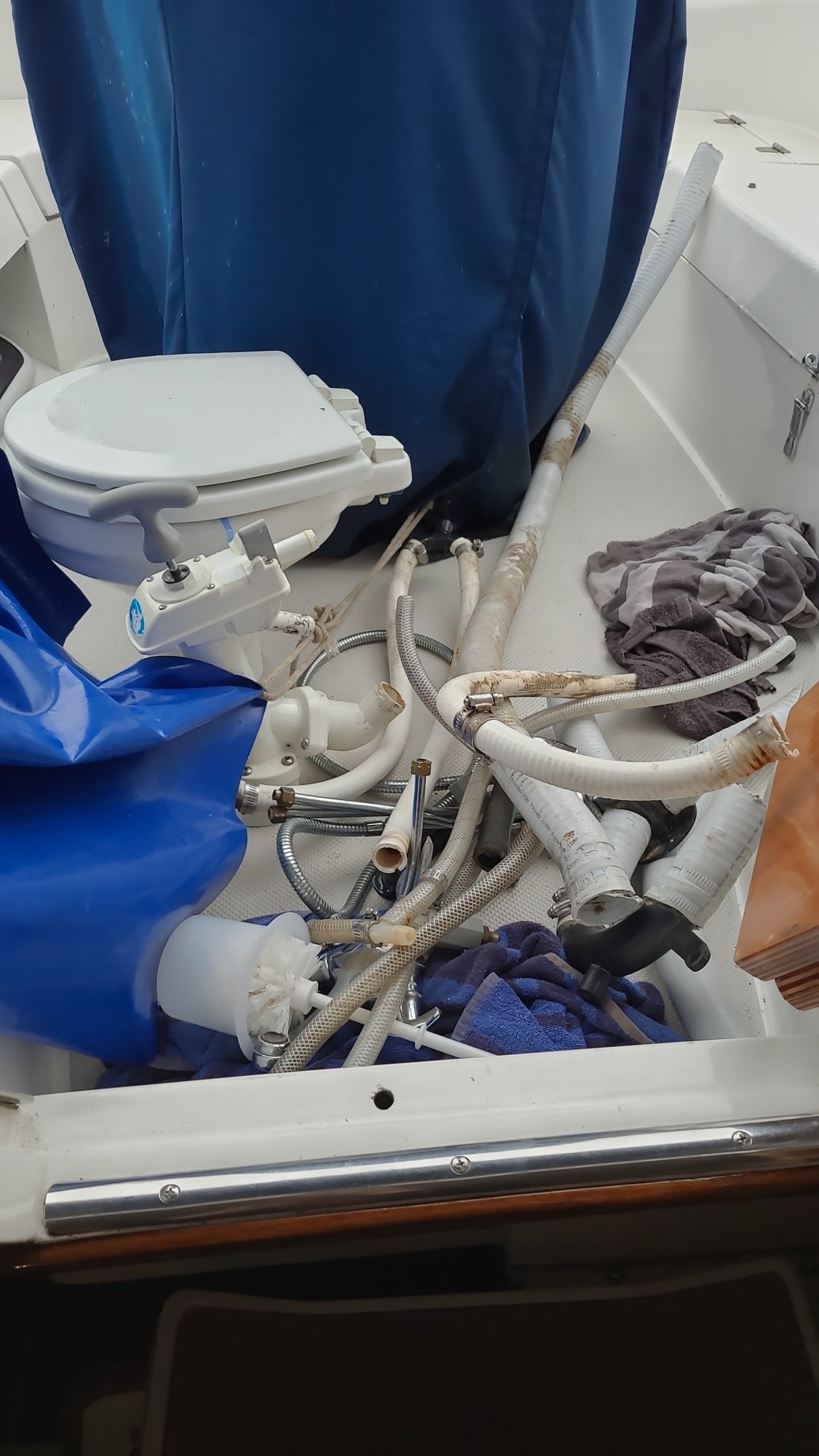

I have a 2002 Catalina 310. I bought the boat in 2020 and had the issue you describe with the head though it also stank while motoring. Since i wasn't sure of the exact cause, I replaced all the hoses (not needed in your case), and, most importantly, added a large diameter through hull tank vent using the diameter Peggy recommends in her book. That solved the problem. Subsequently, I religiously use NoFlex and have installed the Raritan Fresh head (manual) Peggy references. Zero odors since. My only complaint is it really takes a toll on fresh water supply which could be a drag if extended cruising were something I did. Since your boat is new, I am wondering if maybe the tank vent is your problem? On the 310, I don't my original tank vent allowed enough air exchange.
