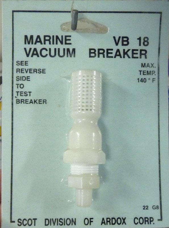

As for siphon breaks, the best vented loops or siphon breaks I have ever used are made by Scot Pump Company in Florida. They are a 316 stainless tube with a white plastic vacuum breaker.
I only know of one distributor of these excellent siphon breaks locally and that is:
Portland Yacht Services Parts Department
Joe Glantz
207-774-2408
Joe can also sell you a new breaker minus the u-shaped tube for about $20.00
Complete unit prices:
1/2" = $48.00
5/8" = $50.00
3/4" = $62.00
Call Joe for other sizes.
Vacuum breaker only price:
VB-18 (1/8") = $20.00
also comes in VB-38 (3/8") and VB-34 (3/4")
Note: the vacuum breaker is identical on all sizes and only the 1/8, 3/8 or 3/4 bottom threaded adapter fittings are different.
Complete unit:
VB only
I used one on my own boat as I have found no siphon break that works better or lasts longer (my piping is custom made and I just stuck the VB-34 on it):
[/quote]
For a waste system you will want to use the smooth radiused stainless tube to prevent clogging. For my raw water system on my motor I made my own siphon break with bronze fittings. That vacuum breaker has 3000 engine hours of use!!!!
