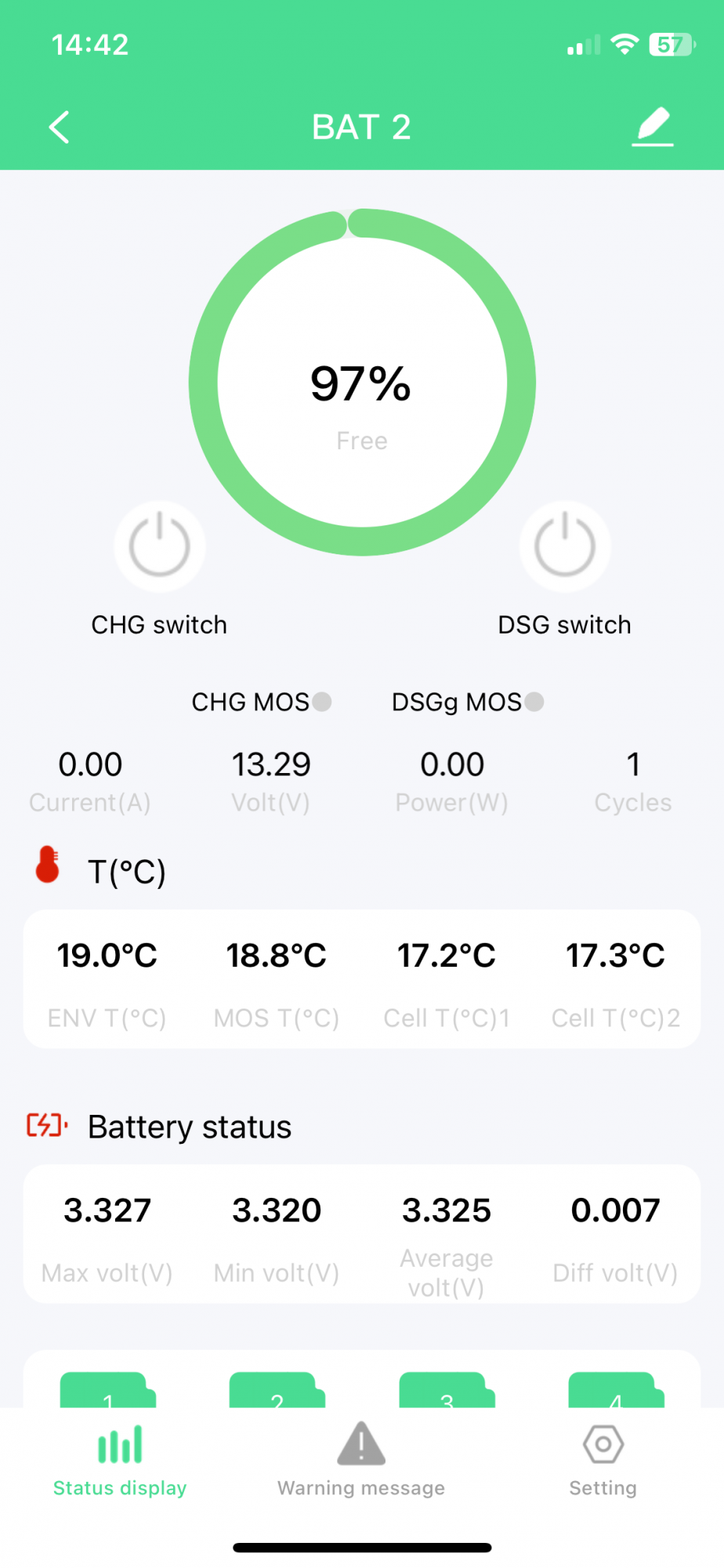

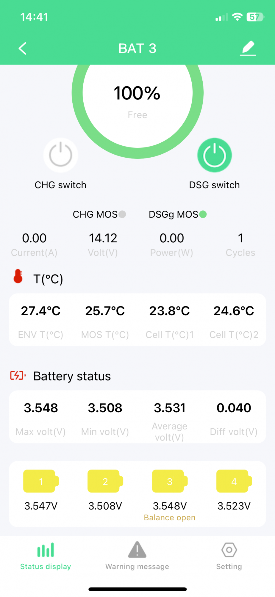

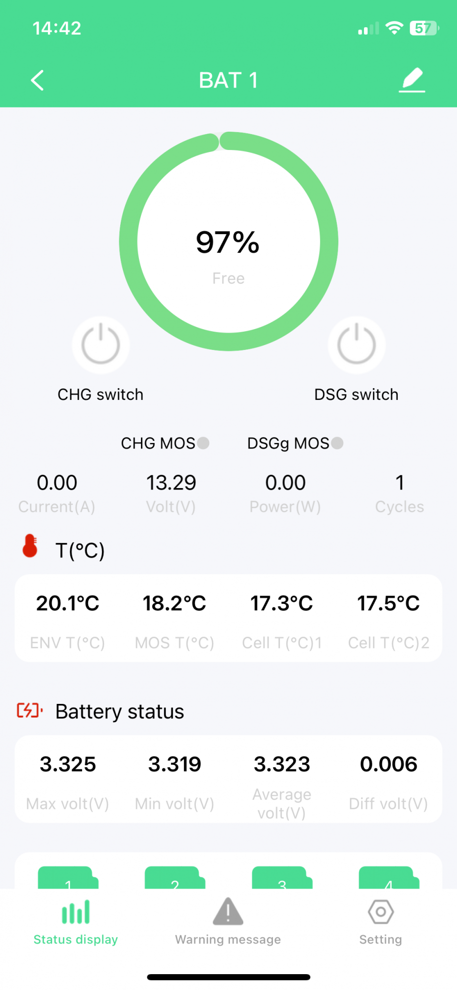

This charge action was on 12 November. I recorded the BMS data.

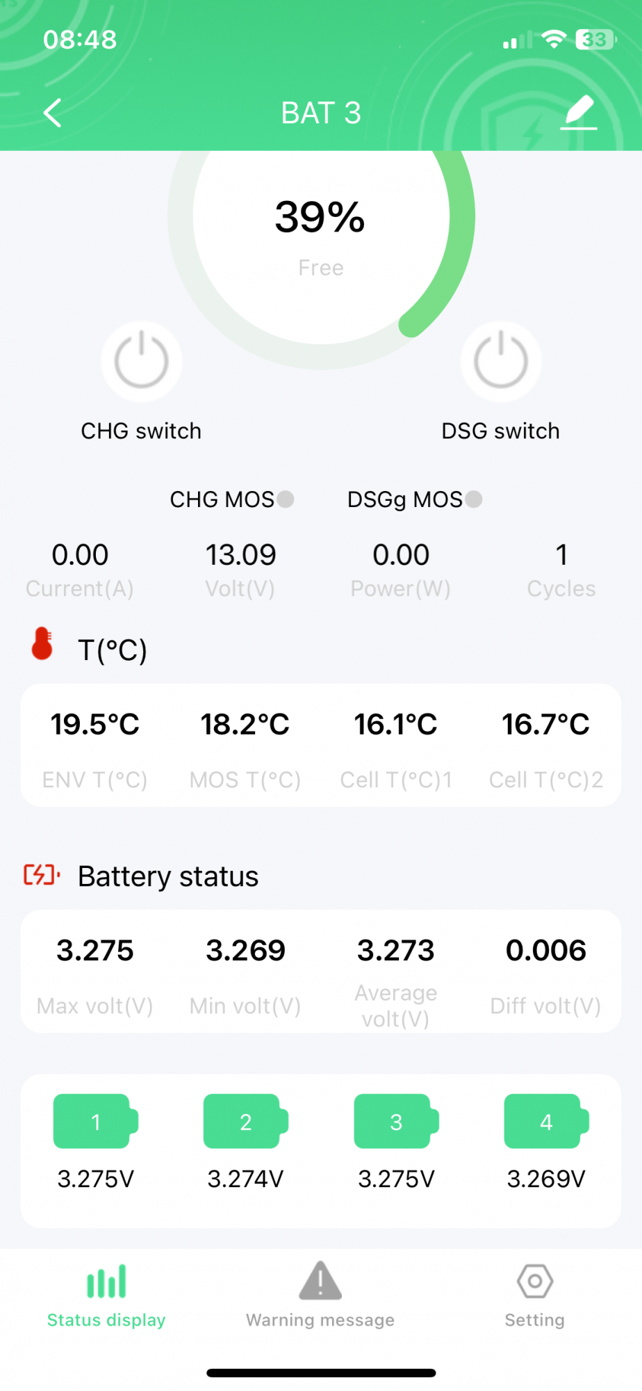

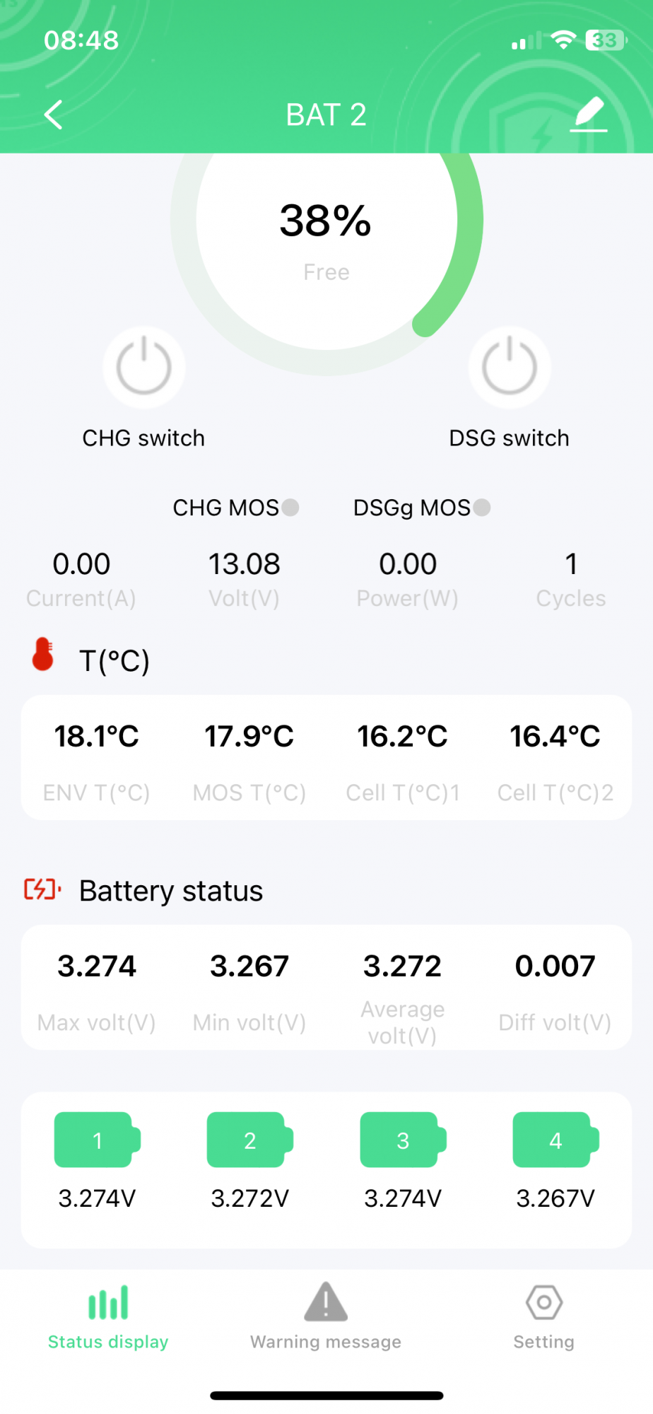

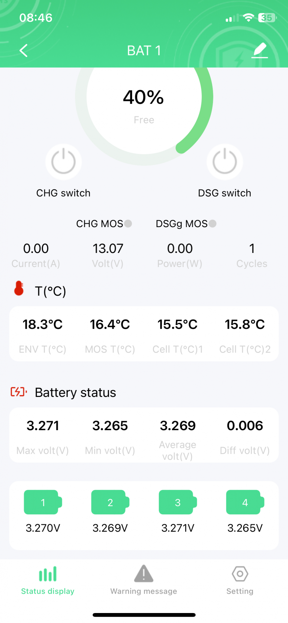

Now, on 01 March 2025, after about three and a half months of storage at a 55ºF temperature without any charge, they have stabilized at a 38-40% SOC.
While this is much less than I would have guessed compared to my FLA batteries, due to the LiFePO4's ability to discharge to 80-100% of their capacity, they still have an adequate charge to provide 1 to 1.5 days of power for my house needs had they been resting on the boat all this time.

Back to the original question since I drank too much coffee this morning...
For the discharge over that time period.
For BAT1 and BAT2, although the BMS is saying 97%, the voltage is only like 3.32 in the cels or so, which would correlated to around an 80% charge level using the simplistic 'volts<=>soc' method? Assuming they had been left to rest for a couple hours.
So doing a full charge with all cels into 3.55v area should help the BMS get synced up to a proper baseline.
BAT3 is up in that area, but has pretty wide differences between the cels. It looks like it is balancing - with cel #3 being told not to charge at the time of the screenshot? Would it be the situation that the cables to BAT3 are substantially shorter than those to BAT1/BAT2, so it is getting charged faster?
Still seems like a lot of parasitic loss though, more than just the battery BMS. I know a lot newer boats consume juice even just sitting. My boat for example has three CO detectors, factory wired in so they are on even with the battery switch off. They are 37ma each, tiny, but adds up over a few months time. 0.037 * 3 * 24hrs * 90 days => ~240AH ?

I may not have this right but it looks like the batteries went from 97 percent to 38 percent in 3 months (or so). That is a discharge of 59 percent which I believe is way higher than you would expect with LI batteries.
Some rough calculations regarding leakage current..
Battery capacity is 100 amp hour so battery lost 59 amp hour. There are approx 2196 hours in three months.
So the leakage is 59 amp hr/2196 hr = .026 amps. Ie, if we ignore actual self discharge (which should have been only a few percent), there was a parasitic load on the battery of 26 ma. Maybe the BMS itself is why this parasitic load? Seems high?

Makes sense that the screenshot is right after BAT3 was charging and hence still that higher voltage showing.

Also - in OP's charged battery screenshots. I don't think they got to a true 100%. At least doing the simplistic volts<=>SOC, they seem more around 80%. My understanding is that if charging at a very high rate - the battery volts will get up into the 14.x range, but the cels aren't really 'full'?

BAT1/BAT2 show about 3.32v when charged and after resting, which corresponds to 80%?
Then later, they show about 3.27v, which is about 60%?
So maybe that overall loss while sitting there in the boxes isn't as much as the BMS state of charge shows?
100AH battery, sitting about 100 days, loses about 20% (20AH)...
100 days => 2400 hours
20AH / 2400hrs => about 0.008A, or 8ma.
So could just be the BMS, plus whatever tiny loss from the chemistry itself?
