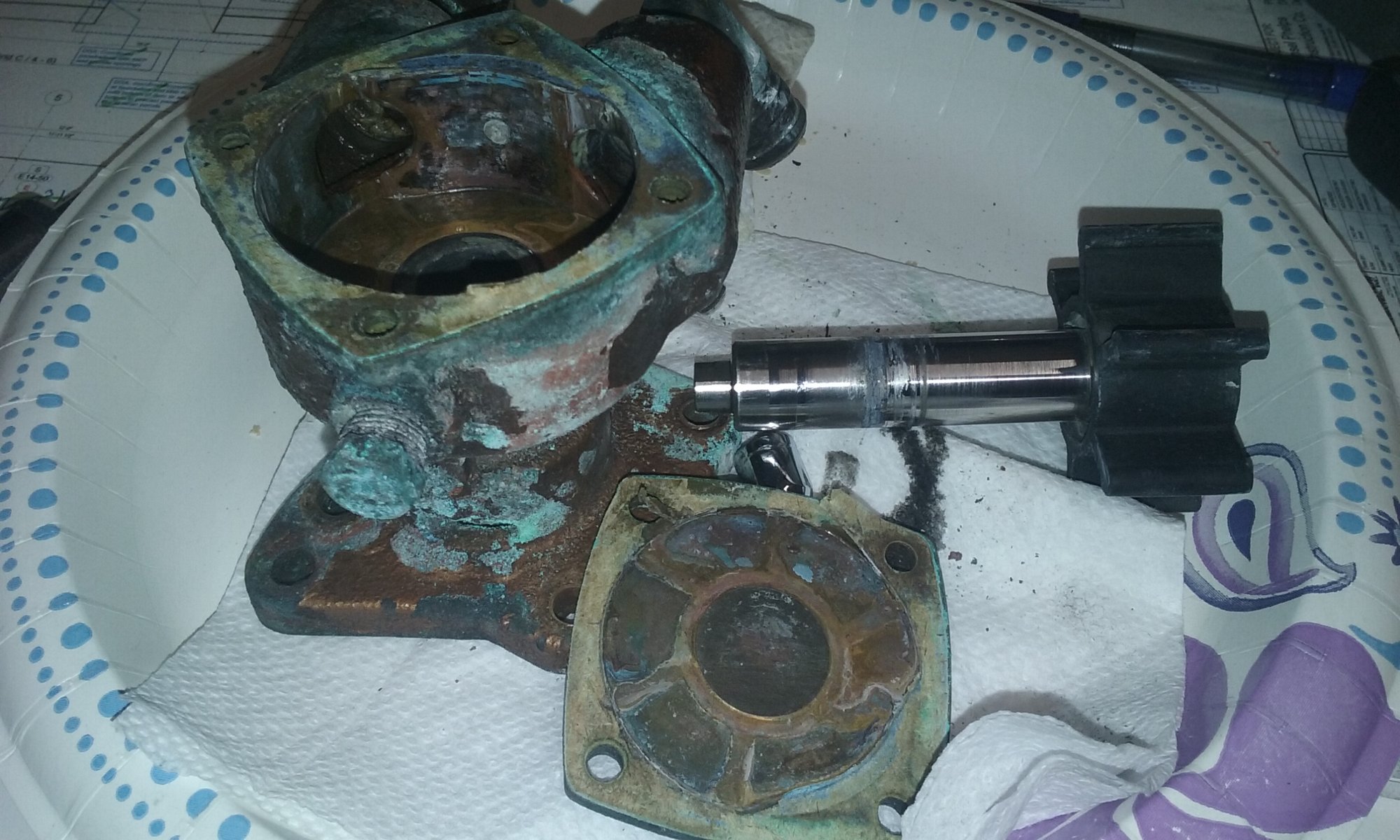

Well, I tore the pump down and this is what I found. It is looking like a new pump is in my future. :(

Sure, you can probably buy a new pump but unless the shaft is scored the rest looks ok.
After a rebuild at 25 years old, the scoring in the bump housing at 40 years was getting more pronounced and some corrosion on the face made it hard to seal the cover so I broke down and bought a new one. I found that I was able to buy a new pump, same Oberdorfer part number as the 1974 original, from a local shop. I figured 40 was a good age for retirement for a pump.

The shaft has bad scoring. The cover plate has ridge at the center and edge a few thousandth's deep.
After some more investigation, I can get the parts from Fisheries which delivers to my marina twice a week.
$86.00 - 11691 Repair kit (impeller, (2) gaskets, o-ring, snap ring, (2) lip seals, carbon bearing)
$61.00 - 8767 shaft
$37.80 - 6597A (cast cover plate)
$184.80 - total
I can get a whole new pump for $247.71 with free shipping from Amazon.
So now the question, is it worth $62.91 to get a new style pump with the 0-ring cover plate seal instead of the paper gaskets that I have been fighting for the last 22 years. Most times that I replace the impeller I seem to have leaks no mater what I do to seal the cover plate.:banghead:
