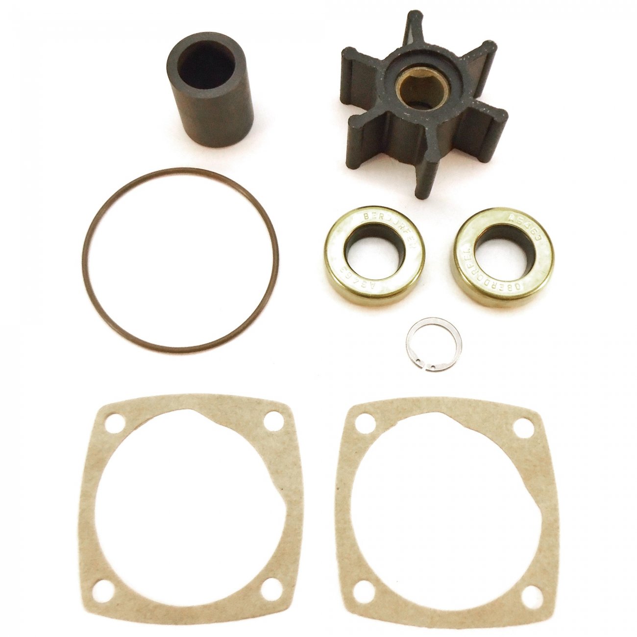

Leaking from the weep hole is likely merely the common and intentional indicator that the bearings need replacing.
Bearing kit is I think $40. Rem pump and then press bearing in professionally or you can do it.
Reinstall pump and ready to go.
No need to buy new pump.

With that few hours, you may not have a bearing problem.. The seal is leaking and you can change out the seal pretty easily.. I always have a couple of seal spares aboard.. They can fail quickly if ya get into some sandy water that gets pulled into the pump.. The seals are standard items and are relatively inexpensive..
Yes, seals! :doh:
In my mind they look like bearings, so subconsciously typed it.
But might as well change the bearing too while you're in there. I think it's plastic, and comes in one form of the kit.

buddy, you don't have a problem with the bearings. They rarely need to be replaced, but if when you replaced the seals and you scored the bearing, then it's gonna leak.
The issue is NOT one of cooling.
It's IS leaking through the weep hole.
You're there, we're not, but it is the seals, cuz that's what leaks.
While you're there, look carefully at the bearing.
Replace if necessary.
Seals leak. Bearings don't unless there's a scratch that lets water or oil past the outside part of the seals that butt against the bearing.
As long as the pump turns and the impellers are OK, it'll keep cooling.
But if there's any leaking through the weep hole...can you guess?:)
PS - from an M25 owners who has rebuilt his Oberdorfer a few times in the 21 years of owning this boat.
I got 1300 hours on my first rebuild, 800+ on the second one, but turned out it wasn't the seals, one of my studs failed - different story. I rebuilt the seals anyway that time.
Gasket number from Universal is: 1 gasket 6593 But look at the TOAD website to confirm, this is 10 years old. I bought a bunch and now get the from my local Kubota tractor dealer for a fraction of the price.

That gasket is only necessary on the old pumps that don’t use an o-ring. I upgraded a -3 pump for a -16 to let me check the impeller without replacing the gasket and also eliminate the freeze cup.
