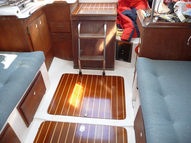

Hey Lee, I replaced my sole (Both pieces) (84 h27) using teak and holly plywood. Paid $200 for 4X8 sheet and CAREFULLY cut myself using original as template. Bought at World Panel Prod in Windsor, NC. (http://www.worldpanel.com/products.asp) Replaced top step over engine at gangway with some of the remaining wood and still have a few feet for future projects. Tony

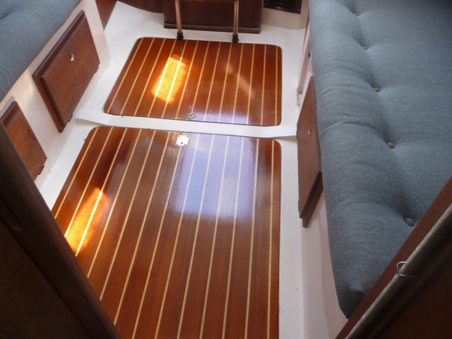

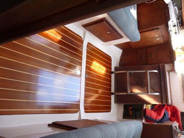

Zipkruse, here are a few photos of the teak/holly plywood I used to replace sole in '84 h-27. The floors are 3 years old, although I refinished a few months ago. Tony

That's beautiful. How do you refinish? I m buying a boat with orig teak/holly floor and needs to be redone.
