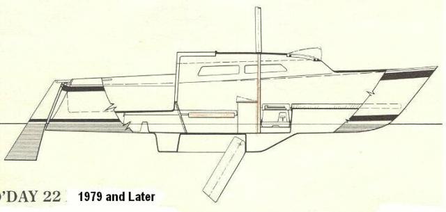

View of O'DAY 22 hauled out (1972-78 models) showing original design of shallow (1'11" draft) keel. 1979-83 models had the K/CB with a bd up draft of 1'3" and bd down of 4'3". I decided to add a drawing of the 1979-83 version to clarify.
