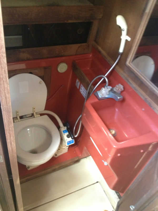

Water is leaking out of the center of the bathroom faucet. Where can I get a replacement faucet that fits. Also the toilet does not flush water at all when I push on the lever. How do I find out which toilet this is for a rebuild kit or does that rarely work out? If I need a new toilet where is the cheapest place to get one that fits easily.

There's nothing arcanely "marine" about faucets...check big box hardware stores or, if your faucet has a fitting to attach a handheld shower, RV supply stores.
Before we jump to any conclusions about your toilet...first thing to check: is the intake thru-hull open? If so, what's the make/model/approx age of the toilet? If you don't know post a picture that shows the pump (all bowls look alike, so a pic of the bowl won't be much help)....and exactly what do you mean by "push on the lever?" What lever? Describe exactly what you do to try to flush it. Once I know what you have and what you're doing I should be able to tell you what to do differently or what you need.

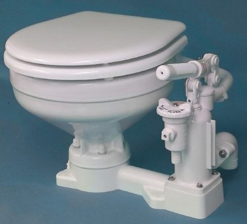

It has to be an earlier model of one of these:
The first on is Jabsco, the second one is a Raritan PHC. Don't buy anything till we trouble-shoot it, starting with making sure the flush water inlet seacock is open.

They def changed the toilet by 82 because that one has a plunge down handle it looks like and mine has a handle more the the second head in the other pictures
No way is your toilet original, 'cuz unlike houshold toilets, marine toilets don't last anywhere near 35 years...nor does any other equipment on a boat. If has a level handle like the one in the photo on the right, it's most likely to be a Raritan PHC. But let's not jump to any conclusions till I can see a photo of it.

Im in Cleveland for my moms heart surgery , my buddy is on the boat , he txted me the pics of the toilet but I'm unable to save them so that I can send them , I have a picture of the broken seacock
