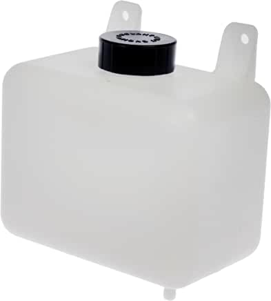

Also have a M20. I bought a generic water tank for $11 from Amazon
Dorman 603-001 Coolant Reservoir Bottle, White Universal Fit
(some folks like pictures :))

In order to properly use an expansion tank, you need a bi-directional, cap for the coolant reservoir / exhaust manifold. The bi-directional cap allows for coolant to be pulled back into the cooling circuit as the engine cools.

@ eherlihy. Are you referring that the unit I have is an incorrect unit? I'm not following, obviously.
Jun 11, 2004
1,933
Oday 31 Redondo Beach
The bi-directional (two-way) cap is the "radiator" cap for the coolant fill on the exhaust manifold. Not the one on the expansion/recovery tank.
