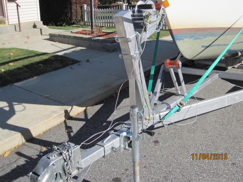

I'm looking at the third picture and it appears to me that the port forward bunk support is leaning over toward the center more than the starboard side. That may well be an optical illusion, but I'm curious.
Your new axle looks like one of the >5000 Lb jobs. That's a great improvement over what you had even before it broke..
Yes 203, you have that correct...no optical illusion. That's how I bought her...seemingly bent on purpose as that's schedule 40 pipe, but I could be wrong.

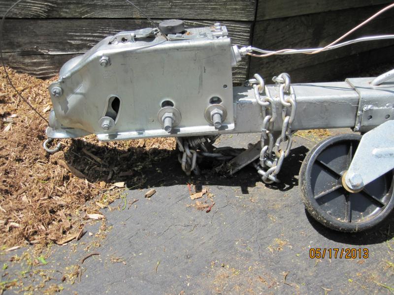

I don't have a trailer yet, so I am very interested in everybody's configurations. I am going to get a basic trailer frame locally and modify it for the H22. So I have been worrying all kinds of folks here getting together measurements.
I'd love to get a good picture of your trailer tongue extension, as one of the trailers I am looking at is very beefy, and would be great but it's only 20 ft long and I think that may be too short since I can't move the wheel location.. galvanized trailer with welded in shackle locatons. I'd have to cut up the trailer to make it work I think, or move the boat so far up on it that a tongue extension would be required.

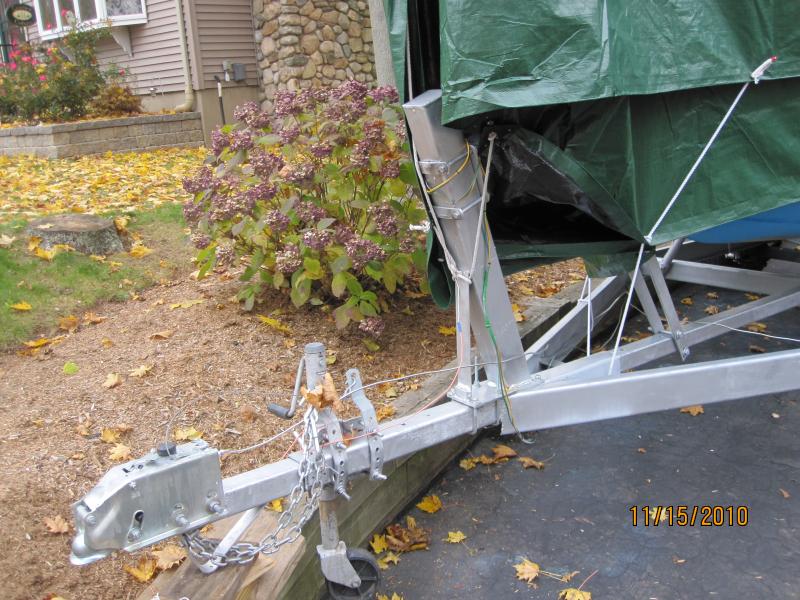

203: re: "...I'd love to get a good picture of your trailer tongue extension..." (see the attached pix).
If there are any other details you need, let me know.
