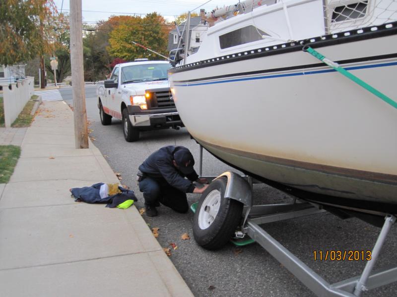

Well, it's the end of another sailing season here in southern NE for me, and time to haul out the boat (1981 H22 swing keel). On the way home with boat on the trailer I notice a billowing cloud of smoke around the right wheel. This trailer is an original (Magic Tilt, single axle) and I'm the 4th owner. Pulling over to a side street, I see the right wheel suddenly and magically "tilts" inward. I wondered if THIS is what is meant by a "Magic Tilt" trailer.. naahhh, couldn't be. :-}

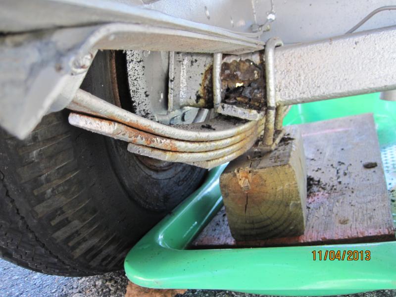

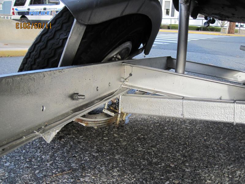

Upon further inspection, yes you may have guessed it, the axle failed... right under the leaf spring u-bolts area. It had rusted through inside to out. I kept up with visible rust control & painting, and the trailer only saw salt water 2x / year: launch and haul out. I have yet to take any long trips with it, and am content to sail on Long Island, Fishers Is, and Block Is sounds. Saying something like 'OMG' comes to mind now, but what I ACTUALLY said, I'll leave to your imagination. And to think that I was only ~200 yards from my street... Home sweet home was beckoning to me and my now lame trailer.
Finally the POINT of this thread: As this trailer is the OEM, I'm leaning towards not repairing or replacing the axle / wheels. Rather, buy a NEW TRAILER altogether. Thus I need your help!! Hey, all you swing keel H22 (older version) owners out there, any recommendations / experiences with a replacement trailer??

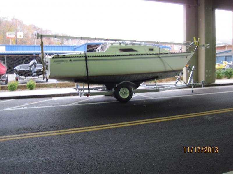

I only use two straps on the toe rail to the front of the trailer (one port, one starboard) and the belly band in the rear, besides the bow eye to the winch stand, to secure the boat to my 32-yr old OEM Magic Tilt. (see below... in this pix, after being flatbed towed, I patiently await axle, springs, and u-bolt replacement at a local yard).

On strapping that boat down, do not use the two forward straps as it could damage the boat over time. I note on the cockpit deck coamings that you have winches. I would run the rear strap behind the winches twisting them twice and forward on the trailer which is how I did all my boats if that could be done. When you look at the larger boats being commercially hauled, you will note the straps in the rear going forward and the one on the bow going backwards. Just remember those trailers do not have trailer tongue supports thus the strapping as described above.

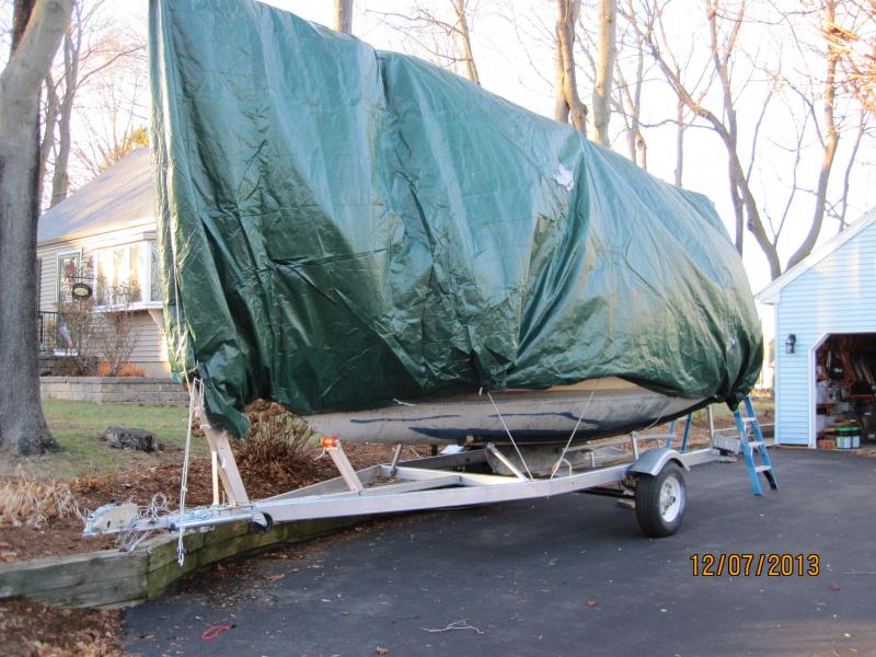

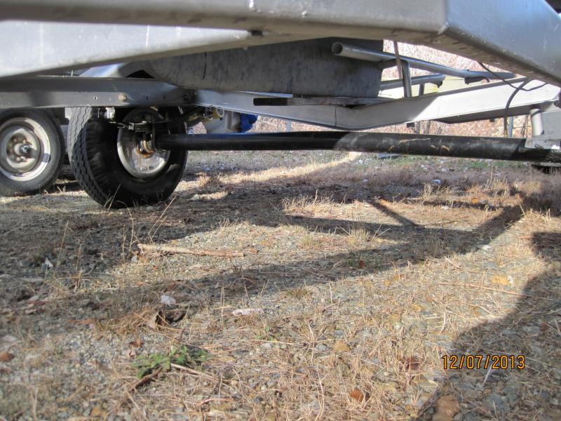

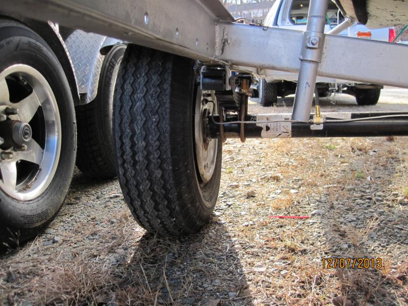

Well the axle, U-bolts, leaf springs and both wheel cylinders have been replaced. The boat now rides a bit higher (~10") than previous...which I like. It's good to get boat and trailer back home again.
Thanks again to all for your input. Merry Christmas and hoping you have a great sailing year in 2014!

I'm looking at the third picture and it appears to me that the port forward bunk support is leaning over toward the center more than the starboard side. That may well be an optical illusion, but I'm curious.
Your new axle looks like one of the >5000 Lb jobs. That's a great improvement over what you had even before it broke..

The higher ride will make launching a little tougher! I see they oversprung this axle to replace the undersprung one. Good luck
