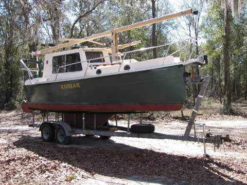

If you'll look at the pic below of a "Nimble Kodiak" it has something like what I think the O'day guys are doing. The upright that is supporting the stepped mast just forward of the house is the lower mast and tabernacle. I think this style comes from Northern Europe and people sailing canals the don't have draw bridges.
Esentially, you cut your existing mast above deck level and install a hinge mechanism. This alleviates any requirement for structural changes below deck or in the deck as the mast is still supported at the keel.
Good luck and let me know how it goes, however you tackle this. I like to hear about innovative boat fixes. I'm funny that way.
