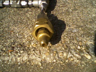

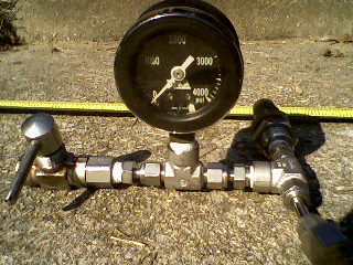

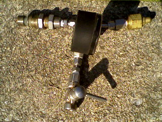

If you build your own manifold, you can fill your bottles for a couple of bucks each.
There are several fill stations in the SD area.

confert to propane
NOT available.
I have a manifold and yes it is cheap to fill up. $1.29 for a 20 hour bottle last year. Unfortunately I have to make a 2 hour trip to get to the pump.
