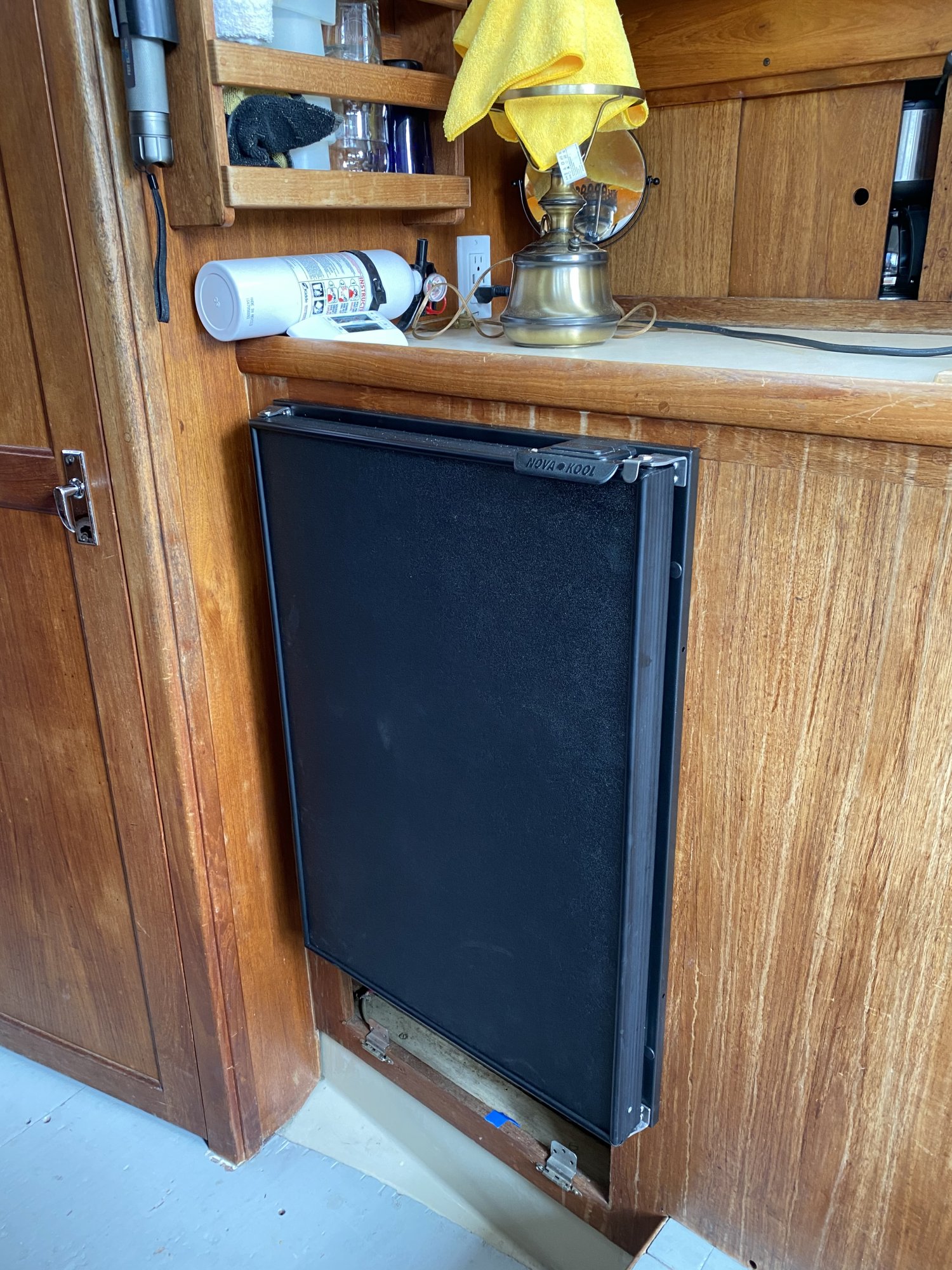

I bought one of the NovaKool freezers during the Seattle Boat Show.
Installed nicely.
I set it and the unit maintain 36 degrees. Very stingy on battery. Silent in operation. Auto switch AC/DC.

Yes. I’ve had it in operation since mid June. Running smoothly cool.
