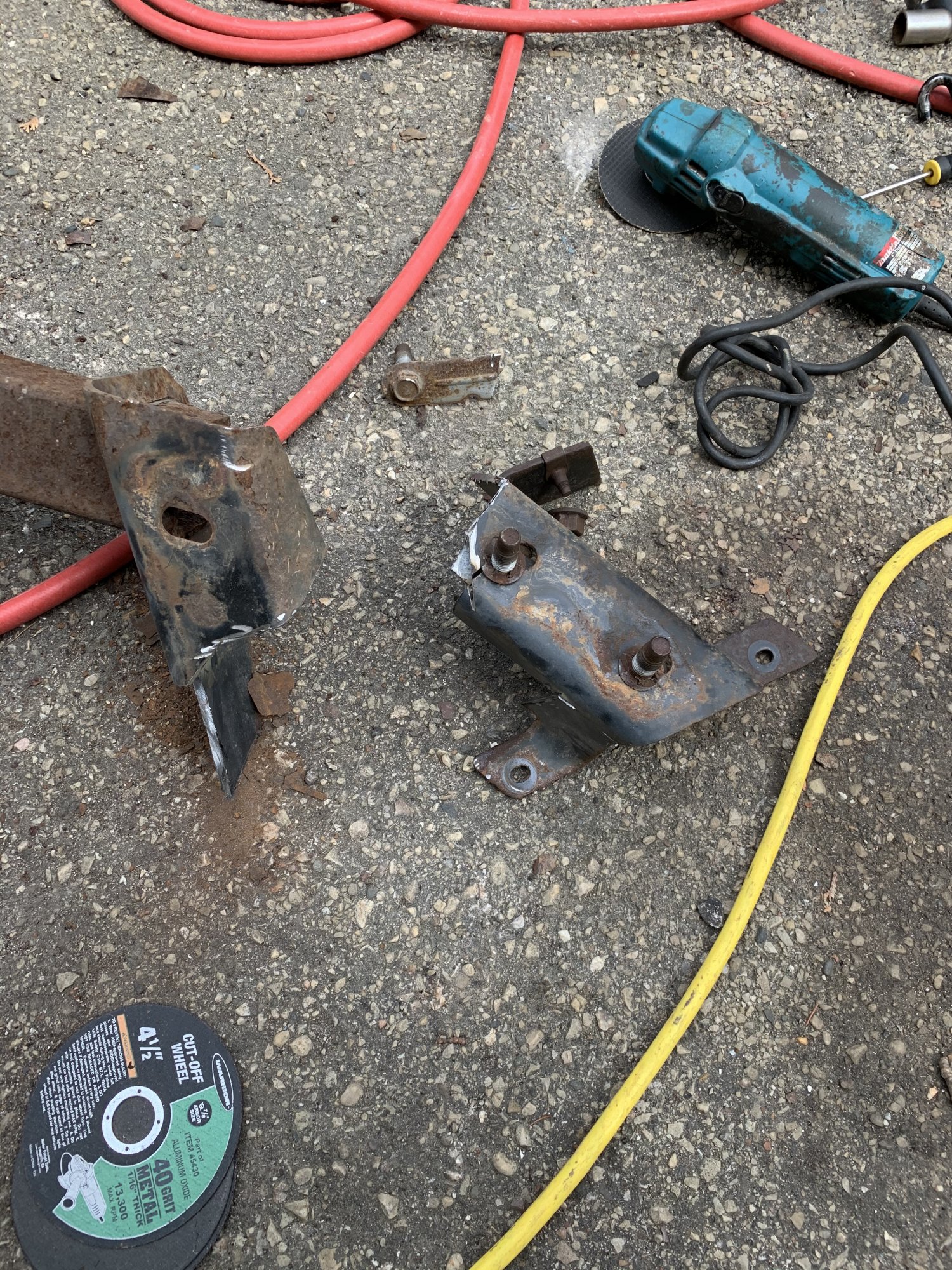

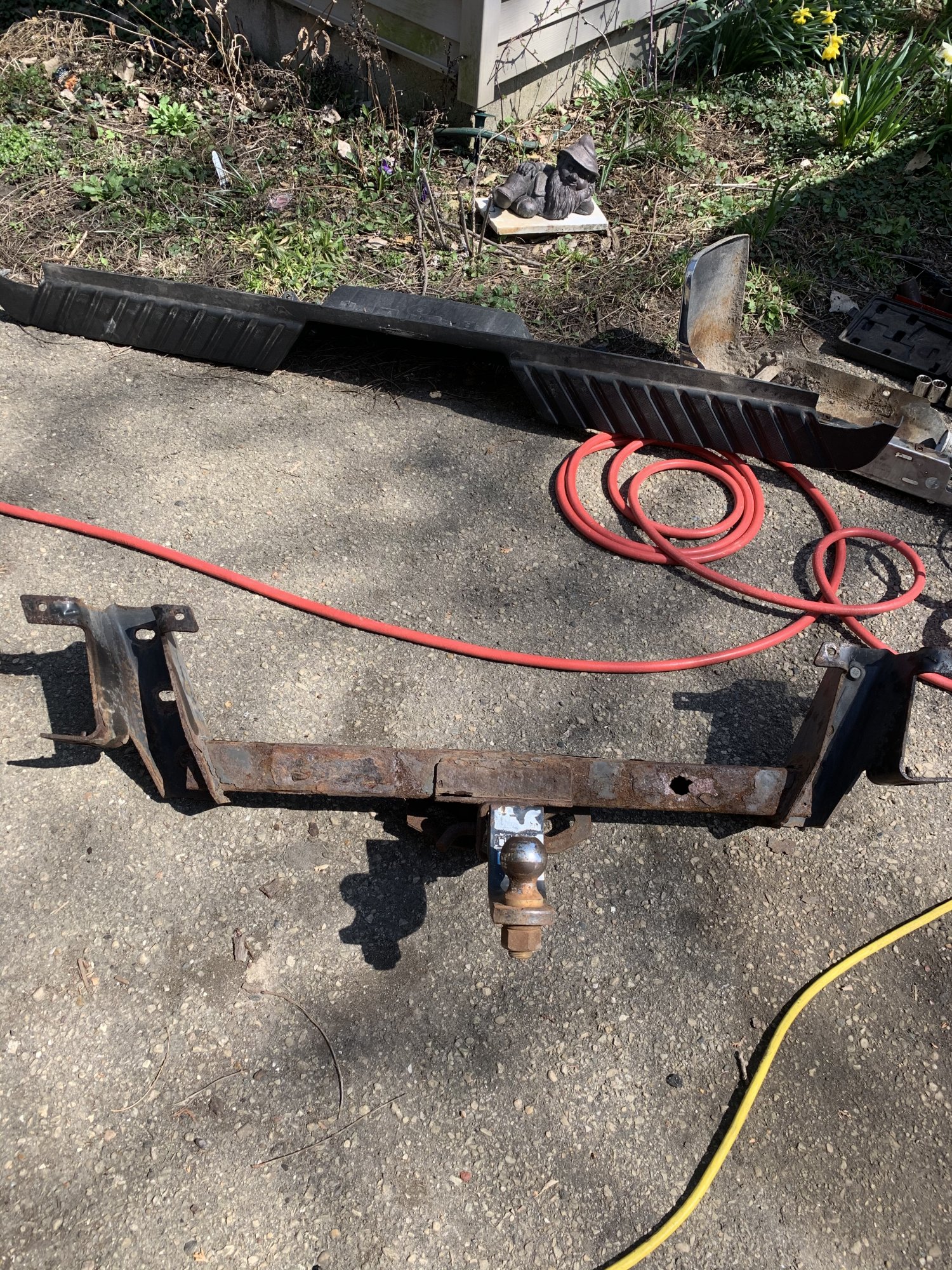

I was hooking up my flat bed trailer , when I noticed an oddly placed rust hole . Upon further inspection , I determined the factory installed receiver had rusted through
I’m grateful to have caught it before I hooked up the boat . Until this happened to me I had never heard of this .
I ended up having use the ends of the ordinal to be able to mount the bumper . Do yourself a favor and check yours

No Will , the truck sits parked about 28 days a month on my asphalt driveway . There was no rust on the truck when I bought it 4 years ago . I have never seen this much rust on a vertical surface before .

Just think about how many of those are out there, that shouldn't happen to an 11 year old, had to be some bad steel there.

Looking at the orin photos, it appears bolts being over tightened depressing the tube in which may have weakened the tubing causing failure???

Respectfully Dave ,I don't think so . The 2" square tube fits into a square hole on both ends I'm not understand how the bolt torque would affect it . The original reason for the post is to let others who trailer become aware that this may happen . It only takes a minute to get on your knees and take a quick look. Are all the bolts there ? Are any lose ? I couldn't even imagine the liability of a trailer coming loose on the interstate . So what if I'm insured to the hilt ? I wouldn't want to look in the mirror knowing I could have prevented something.
