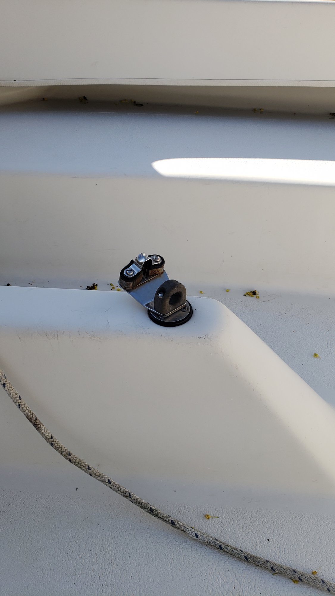

Hello, I have an American Fiberglass 16 that I'm getting ready for the season. I was going over the running rigging and think I need a piece of hardware that attaches to the boom for the mainsheet control. There is a bracket attached to the middle bottom side of the boom and has two holes in it. I'll see if I can attach a pic. I think I run the line from a pulley on the end of the boom, to a pulley attached to a wire that spans the transom, back up to the end of the boom, to the missing piece and down to a swiveling cam type of device. I'm hoping to learn all these terms. Thank you for any help!

Thanks for the replies. I'll take some better pictures when I get home. It looks like I have a combo of the 1st and 3rd drawing.

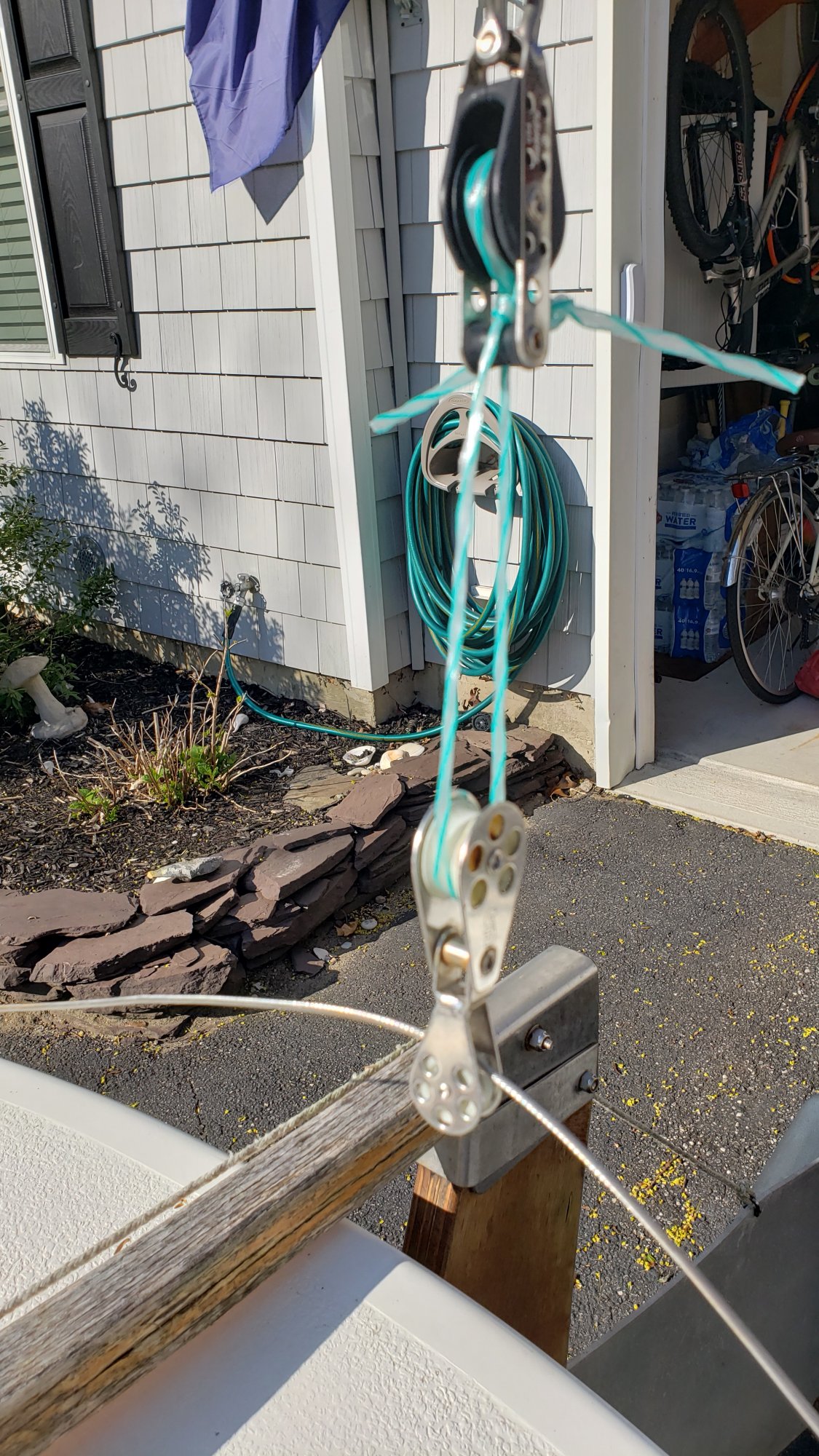

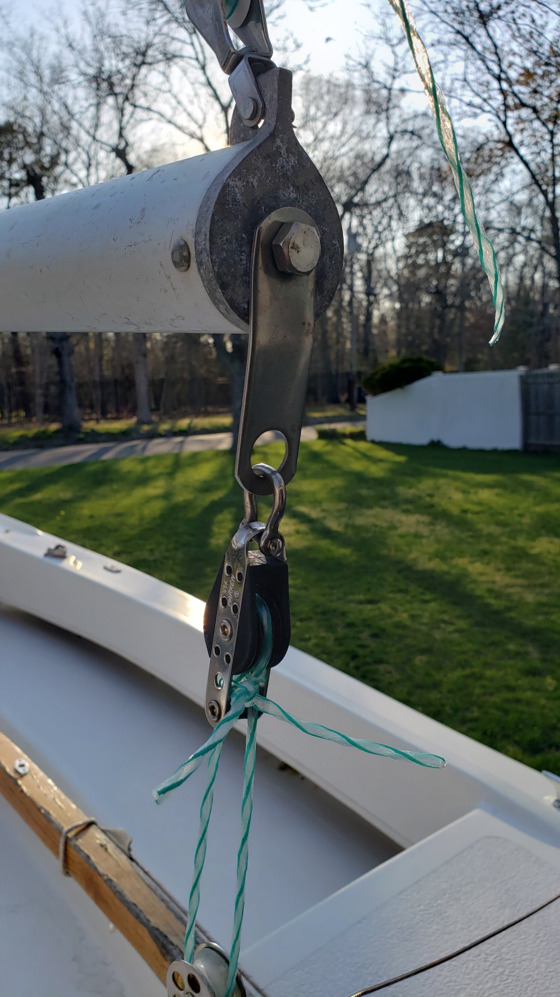

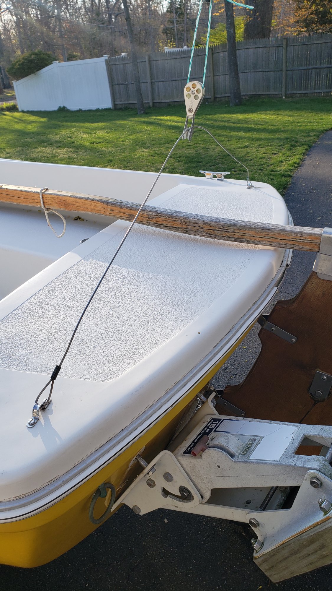

In pic 16595 that seems to me to be the mainsheet cleat on a swivel. That's where I would expect it to be. So that suggests the diagram #3 from rgranger. In pic 16593 that situation cries out for simplification. That is there to add purchase. So the sheet could go from the becket, around the block riding on the transom wire, back up thru a block and forward along the boom. You need a single block, (Maybe attached to the T Track on the boom - not sure about the need for that), or to a bail or pad eye and down to the cam cleat.
I can't see the hardware above the becket block, or how that block attaches to the boom. It seems like that could be downsized a bit. This is pretty much like the Flying Scots I sail at USS Center Martin County. They are 21' and your boat is 17'. I think you can lighten the rigging.
As for the transom wire or line, I've posted before that I don't really understand. It isn't a traveler. What would be different if the blocks were attached to a fixed point such as a pad eye. I guess you would need more main sheet to free the sail but it can't be that much. Meanwhile you are limited to how close you can sheet the main in. That might be good or not. I don't know. Seems to me that it is a throw back to classically rigged boats of the gaff sail era - when mainsails weren't trimmed to the centerline.

Prob with the T-track idea is the tiller will get in the way

I quess the idea of the transom wire is to clear the tiller. Interesting. Thanks for all your time and feedback. I'm just getting into sailing and my kids are excited to learn too. We have always had motor boats but I enjoy all the pieces and putting it all together that sailing offers. I think I will give the guy from American Sail a call and see if he has any manuals or info. I think the simplest items to get are a block that swivels attached to track slide with an eye or a combo of both. Thanks again. Many more questions to come : )

I think if you use a track on the transom, your tiller will be in the way of the main sheet when you come about.
The wire will work but you won't be able to bring the boom to mid-ship on a reach or pointing... Sometimes it is desirable to add a little twist to the main sail and bring the mainsheet to windward side and then letting the sheet out until the main is mid-ship (or slightly leeward) allows the wind to spill off of the top of the sail, reduces heeling and makes you go faster. That is what travelers can do for you. You coud do something similar using the wire over the tiller and then a separate line and block at the corners of your transom to pull the main-line tack point to windward along the wire.
