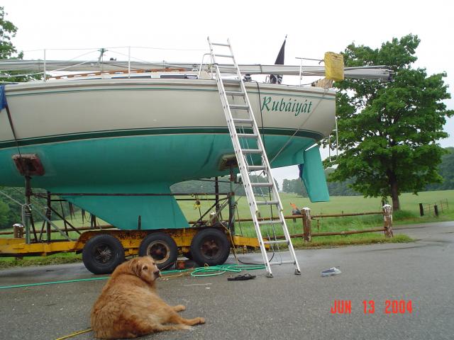

I've wondered awhile about this, I would like to know the true weight of my 85 C30TR for a trailer purchase. The manual says it has (approx) 10,300 lb. displacement and 4500 lb. ballast. I wonder if the boat less the ballast is 5800 lbs.? I've thought the displacement is the amount of water that is displaced by the boat.
Anyone know the actual weight of the boat for the proper trailer?
At the moment I use an old equipment trailer with 3 house trailer axles under it, no lights or brakes though, so we may get a new one that can be legalized.
Thanks Dean
