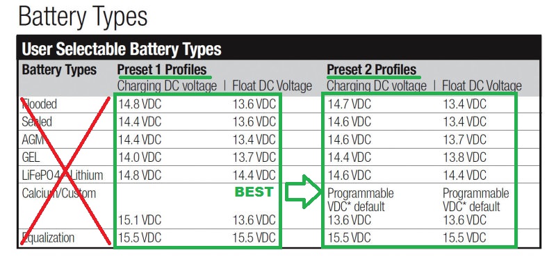

Soap Box:
As a group boaters really, really, really need to stop looking at the words or charge profile on a chargers pre-set list, and instead look at the VOLTAGES behind the words or word defined charge profile. AGM, GEL, Flooded, FDC etc. are words and they mean absolutely nothing without knowing the VOLTAGES behind those words. A flooded setting on some chargers will literally destroy some flooded batteries. An AGM profile on some other chargers will literally destroy AGM batteries.
One manufactures voltage for AGM will NOT always be the same as the next thus boat owners should only focus on the VOLTAGES the words represent. Sometimes you can also see different absorption times behind the words and this too is very useful information. For some AGM batteries you will be much better served using the FDC setting than an AGM setting but a custom setting will always better be able to match the manufacturers recommended absorption & float voltages.
For example Trojan's are best charged at 14.8V absorption & 13.5V float for a PSOC type of use (marine use is almost always PSOC). If an installed starting battery can also be charged at 14.8V & 13.5V then the charger can charge both even if one is flooded and the other AGM.
An ACR just applies the same charge voltages to each bank because they are charging in parallel.. This is really no different than most all so called "smart-chargers" which feature multiple parallel diode back-feed protected outputs. If the float voltage requirements are also the same, or very similar, then one charger can feed two different battery types without issue. All batteries should be charged temp compensated especially AGM's & GEL..
VOLTAGE (and time or timer algorithm) is the key not the words or a "charge profile" simply given a name or acronym..
While a smart charger may have outputs for "three-banks" most are still one charger with one single voltage setting used at a time. You can't for example put a GEL battery that needs 14.1V on output #2 and a Northstar that needs 14.7V on output #1 and then set the charger to FLOODED because you will cook the GEL battery. If you set it to GEL then you chronically under charge the Northstar and also ruin it.
Here is a prime example of ignore the words (Flooded, Sealed, AGM GEL) and focus on the recommended VOLTAGES
Here are some manufacturer suggested charging voltages:
AGM's - Which AGM Preset works?
Lifeline AGM = 14.4V & 13.4V = AGM Preset #1
Odyssey TPPL AGM = 14.7V & 13.6V = Neither AGM Preset
Northstar TPPL AGM = 14.7V & 13.6V = Neither AGM Preset
Firefly AGM =14.4V & 13.2V = Neither AGM Preset
Mastervolt AGM = 14.4V & 13.2V = Neither AGM Preset
Full River AGM = 14.7V & 13.7V = Neither AGM Preset
Rolls AGM = 14.7V & 13.7V = Neither AGM Preset
East Penn/Deka AGM = 14.6V & 13.6V = Neither AGM Preset
US Battery AGM = 14.4V & 13.4V = AGM Preset #1
Trojan AGM = 14.4V & 13.5V = Neither AGM Preset
As can clearly be seen this chargers AGM settings FAIL for 8 out of 10 AGM brands!!!!! This is why boaters should always focus on buying chargers that have a custom voltage setting. Please do not focus not on the words but instead focus on the voltages that the words are representing..
How about Trojan Flooded batteries? Which Flooded preset works for Trojan flooded batteries??
Trojan Flooded = 14.8V & 13.5V = Neither are ideal. So you use custom and set it at 14.8V and 13.5V
How about Deka / East Penn Flooded
Deka Floded = 14.7V & 13.8V = Neither are ideal. So you use custom and set it at 14.7V and 13.8V
* This is but one example of one charger but one that has 11 separate charge voltage settings to choose from PLUS a custom setting.. Some so called "smart chargers" are so dumb as to only have three options AGM, GEL or FDC.
