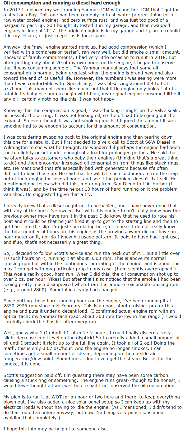

Thanks for your report, Alan. I can see where something similar makes sense in my situation. The diesel did not noticeably burn motor oil in about the first 1000 to 1200 h of its operation. I’ve generally run it 3000 rpm at “full speed” whereas it could do 3200 rpm when full out. So, I’ll start running it full out the next few hundred hours. I see the same slight amount of smoke at times; maybe that will go away as well.

Doing a bit of math on @Alan Gomes 9HP motor vs my 50 HP Volvo Penta, but I do not run WOT. [ 2200/3000 RPM ]
1/8th teaspoon per engine hour or so.
I use much less oil or 0.02 oz/engine hour versus his 0.07 oz.
I never see smoke after start up.
Jim...
