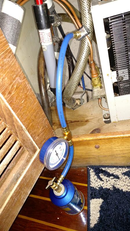

I recharged my icebox conversion this weekend. Added a clamp on bullet piercing valve on the suction side copper line. Used automotive 134a and a hose with the gauge. So in my case it can be done. Others my vary.
Prior to the recharge it would not get cold, just run constantly.
