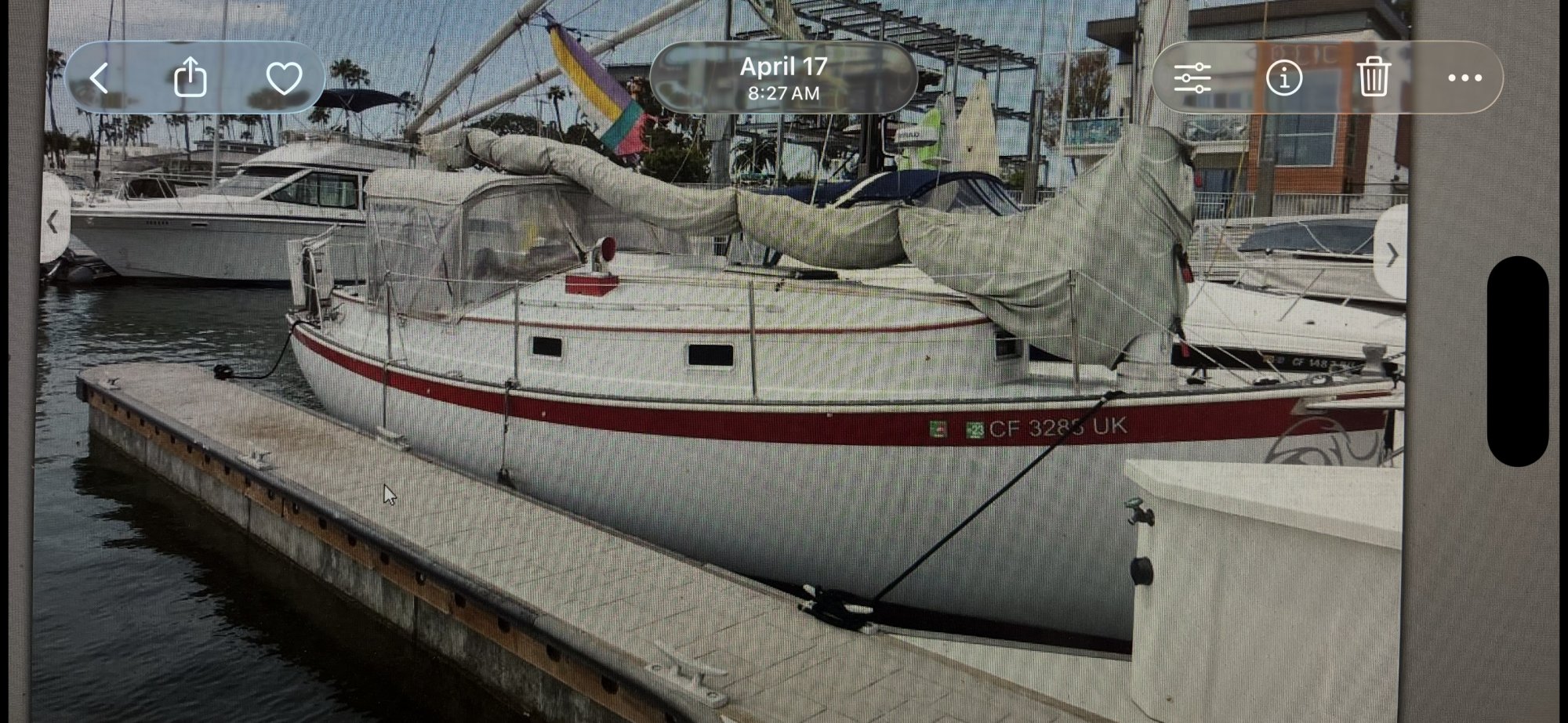

I just picked up a 26' Nonsuch that I plan to use as an accompaniment to my acupuncture practice, so I can take patients out on the water for some "Sail Therapy". We have a lot of stressed-out people in Los Angeles. I have tried bringing patients onboard traditional sailboats, but non-sailors aren't usually comfortable tacking, coming about, or jibing. The Nonsuch seems to solve this with one big sail and no need for the passengers to move when changing direction. I've never sailed on one but watched the videos. This boat was neglected for years and I finally got the diesel running and took it out for a sea test and it runs fine. The problem is the sail is huge, (wrapped in its cover) and it completely obstructs the forward view. I am hoping to raise it up a couple of feet. I have been looking for any kind of documentation of how to support the sail. There are "cradle lines" that attach to the Cat Boom with a similar idea as easy-jacks, but are supported below the boom. My boat's cradle lines look shoddy and loose with a bunch of bungees likely replacing proper lines. I think I can replace these with better supporting lines. I have a Bosun's chair and up-rig that I can attach to the halyard. I'm not keen on leaving the ground with only one line, but that's all the Nonsuch has. I suspect I will be doing John Candy's impression of Peter Pan--I'm flyin! I would appreciate any help with this. Any plans, directions, pictures of a well rigged Nonsuch would all be a help.

The Nonsuch forums talk about "Dropping the Wishbone" This sounds like a good idea for maintenance, but my first problem is visibility. The sail drops so low that it's not safe to motor out because you can't see whats directly in front of the bow, and between the tall mast and the high gunwales, any breeze pushes the boat--a double recipe for a collision
Upon closer inspectioon, the cradle lines that support the sail are way too long, and one is missing due to the missing eyelet (a bit corroded) I plan to shorten the cradle lines with sheapshead knots install a temporary hose clamp to substitute for the missing eyelet, and re-install the missing cradle line. This should restore visibility. If the boat is something I want to keep, I'll try to figure out the "halyard brindle" method to drop the wishbone, but it may warrant a trip to the boatyard and easy access with a crane. Expensive, in my area of Marina Del Rey. But the people in the forums talking of tying the end of an extension ladder to the wishbone could easily lead to a more expensive emergency room visit.
