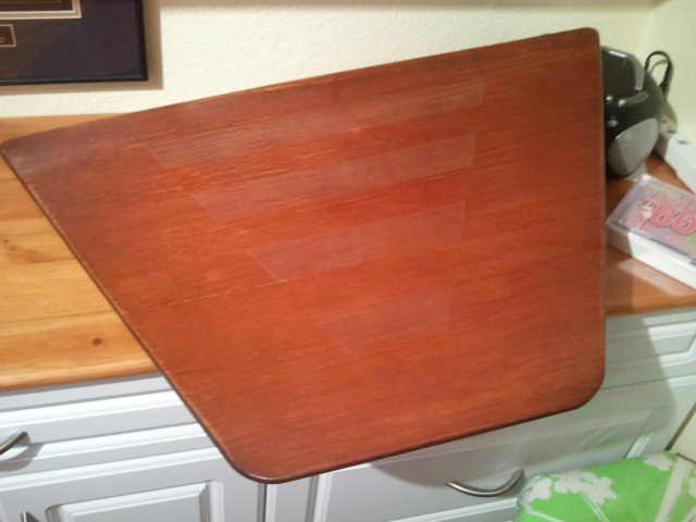

I revarnished my floor boards to the dinghy this summer and wanted a non skid surface. I used a product I bought at Home Depot made by Rust-Oleum called Epoxy Shield. It is a plastic grain that appears clear when wetted out with the varnish. It comes in a plastic pouch and is used to treat 1 gallon. In my case then I figured out that was equal to 1/2 ounce of powder (in a measuring cup, dry) to every cup (8 oz wet) of varnish. I used tape to mask off where I wanted to have the non-skid and applied the last two thin coats stirring the mixture constantly to keep it from settling while I applied it. It gives me the non-slip surface I was looking for.
