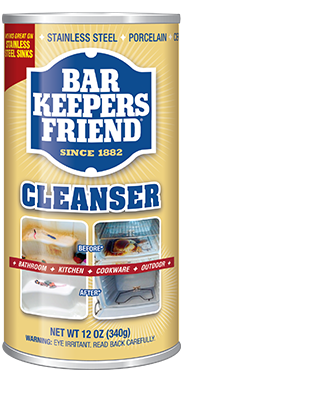

Barkeeper friend is good for some things like Stainless Steel non-polished surfaces, and it leaves film to brighten the gel coat but it is no different than using Ajax on your deck, it's sanding your decks while you clean them.
