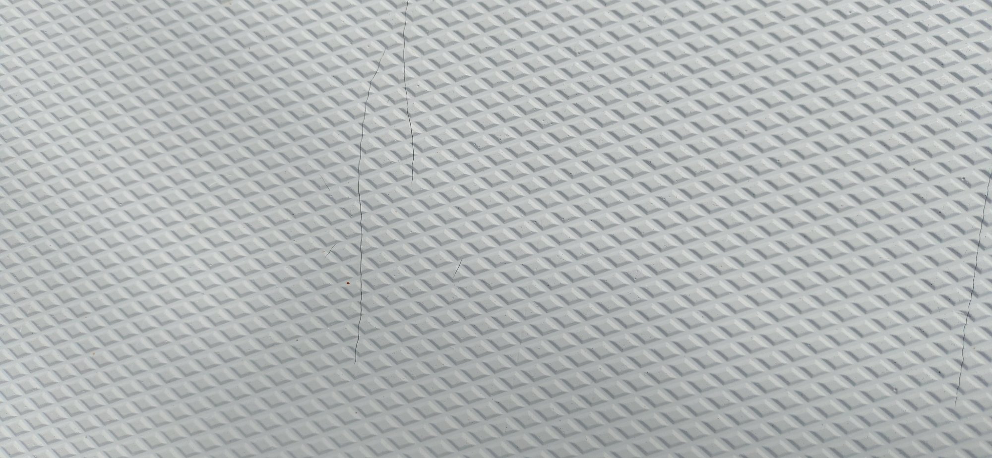

P Peter G . Feb 1, 2005 5 Hunter 33 Fall Rive Ma Sep 2, 2024 #1 Has anyone repaired the hairline cracks in the non-skid areas. This is a 2005 Hunter 33.
A azambella . Sep 27, 2008 184 Hunter 33 Danversport, MA Sep 21, 2024 #2 You need to check out Boatworks today on youtube. He did an episode on making a mold on your nonskid and how to use it to fix you cracks Likes: jssailem

jssailem SBO Weather and Forecasting Forum Jim & John Oct 22, 2014 24,949 CAL 35 Cruiser #21 moored EVERETT WA Sep 21, 2024 #3 Researching the info on BoatworksToday.com. Is well worth the time.
C Crazy Dave Condon . Jun 8, 2004 10,536 -na -NA Anywhere USA Sep 22, 2024 #4 You will need some reverse non skid which the forum store might have for your boat
