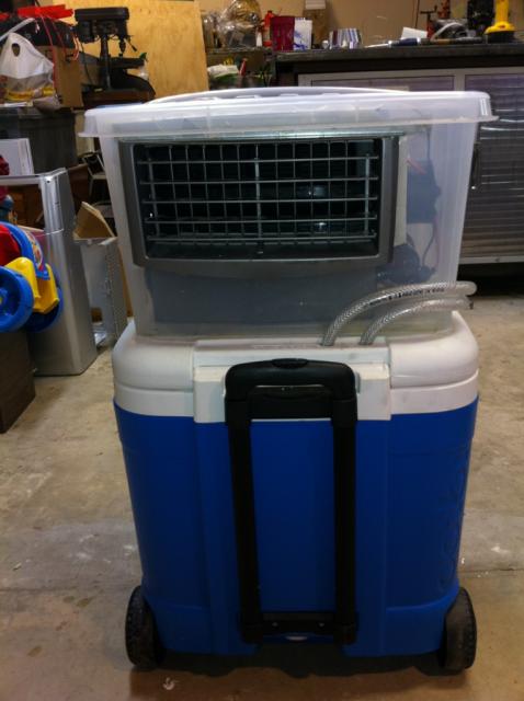

Mybuddy beat me to it. Here is an ice-powered condensing air conditioner that uses ice as a cold source. It will dry the air, as it blows the air through a dry chilled heat exchanger rather than a wet evaporative membrane. No mold due to excessive humidity.
See what you can do with an ice chest, a plastic tote, an automotove heater core, a fan, some hose and a bilge pump?

Nice, oddly, that's the same ice chest I was going to use. Mine gets hauled out tomorrow for bottom job, I'll get back to it after that.
