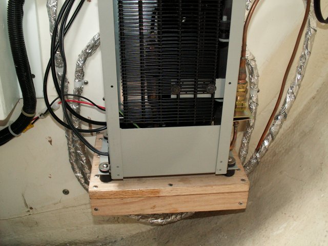

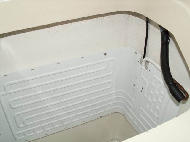

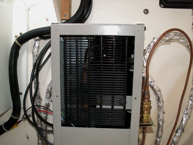

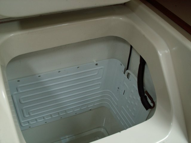

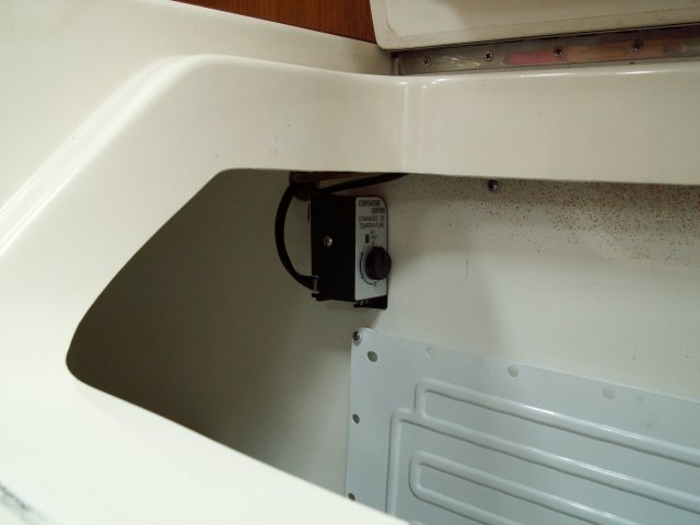

I installed the SCQT-4407 icebox conversion on Ninkasi, our '88 H33.5, almost two years ago. The unit works great when attached to shore power, but does add a healthy load to our DC power consumption. I opted to install it myself and placed it in the starboard lazerette on the bulkhead directly behind the icebox. The unit is very quiet and you can barely hear it cycle on/off even at night. The unit needs good ventilation and the "dungeon" as we call it has plenty of air.
When I installed the unit we had 2 GP27 house batteries and this worked fine for our weekend cruising and day sailing. When we went to FL last winter, living everyday on the hook or moorings was way to much for the batteries and I swapped the GP27s out and installed 4 Trojan golf cart batteries. Everything (the admirals TV, lights, stereo, and refer) works great with this setup and we don't need to run the engine as often to charge the batteries.
Bottom lines: (1) despite its quietness, I wouldn't put this unit in the salon; (2) even with its built in fan, the compressor unit needs lots of air; (3) you are probably going to need more battery Amp Hour capacity if you like to cruise/anchor out for long periods; (4) your icebox may need more insulation, ours did; (5) although not as efficient as water cooled units, the price was cheaper and it was much easier to install; (6) cold beer without hauling ice is great.
Attached are some pics of my installation.

I think my evaporator came with 10 to 12 ft of tubing attached. My Users Manual, which has the specs on the unit, is on the boat. You can see in the pictures that I looped the excess tubing behind the compressor. Thetford (Norcold) has a copy of the SCQT-3407 Users manual on their website with specs on that unit and it came with 12ft. The SCQT-4407 has now replaced the 3407. Check out the link.
