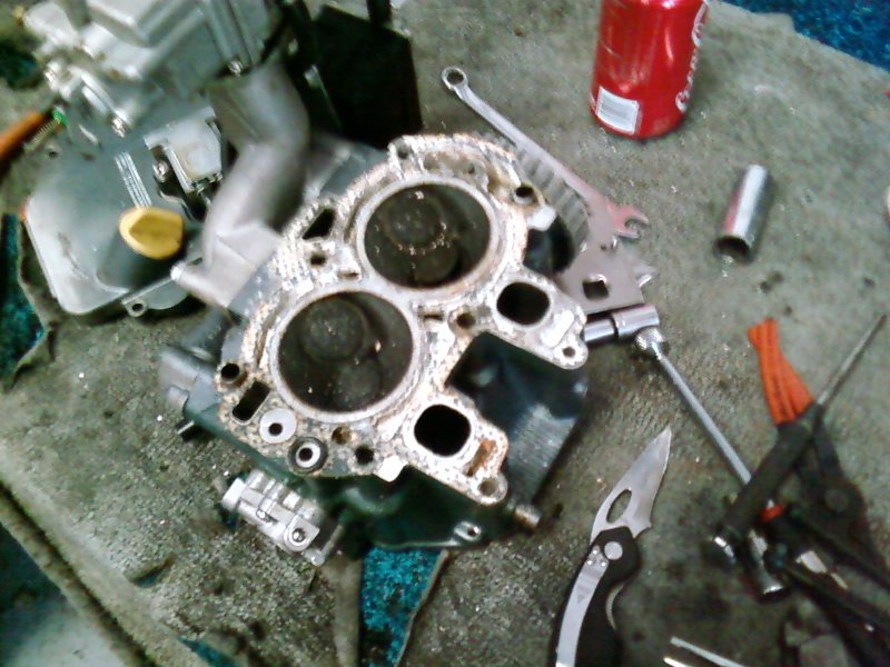

10,209
This Yam 9.9 had sat idle for a few years.. you can see we had to open the cylinder head to get at the deposits.. The exhaust ports on the right side have cooling passages next to 'em. You can see they were about fully plugged..
Yes, it was a bugger to get the water pipe and stuff all lined up..
Likes: Chief RA
