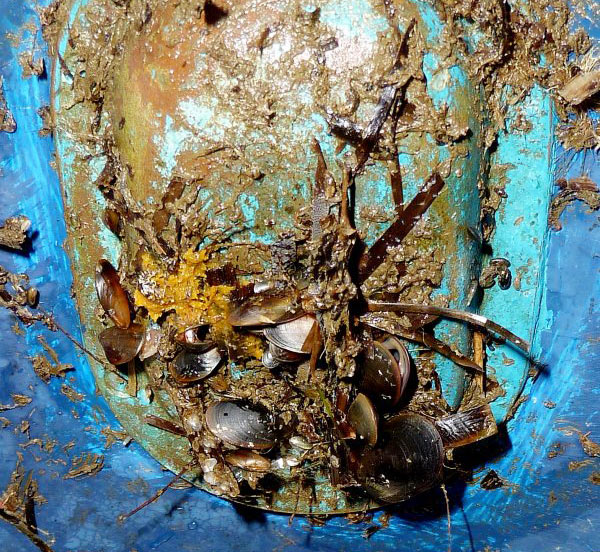

Before you dive, get a piece of hose that will extend from the thruhull to above the waterline, hopefully in a straight line. Attach this hose to the seacock. Use a long thin rod to push down through the hose and open seacock. This may remove anything that has grown or become captured in the external strainer or in the through hull. A long welding rod may be adequate. If you need a longer rod, use some all thread and a connector. The rod should be thin, ⅛" would be good because there may be an external strainer with small holes.

We just hauled and found our intake strainer had barnacles all over it, including the insides. Had to remove it, clean them all off and poke around in the intake hole with a screwdriver to get the ones that were growing in there too. Can easily understand how water flow could be almost stopped by a season's growth.
