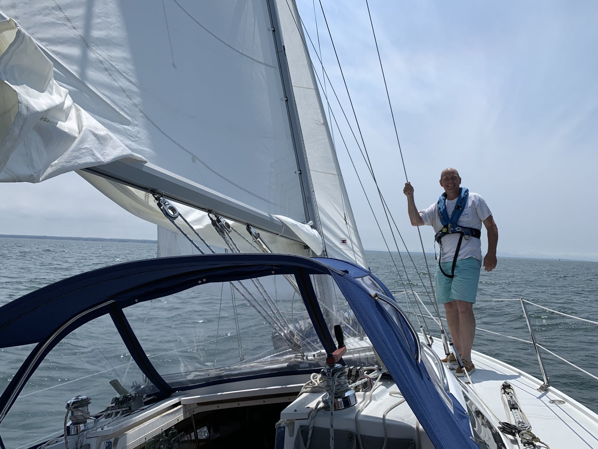

On our Catalina 320, we use the traveler primarily for easing AOA for gusts. I like the traveler in front of the cockpit because the controls are easily used with cam cleats. I hate the clam cleats that the mainsheets are on (our mainsheet is double-ended so there is a cleat each side). I will change these cleats eventually. The vang control line is on a clutch and it is generally off because I haven't gotten used to its position yet. The spring-loaded Garhauer vang causes the boom to spring like a jumping jack when releasing a main sheet. I find that if I ease the main in a gust, the boom lifts far more than it swings. Therefore, the traveler is my control of choice for this situation.
I much prefer the traveler in front of the cockpit instead of inside the cockpit, as it was on the Starwind.
On the stbd side, the mainsheet is leading to the winch from the clam cleat that I can't stand (it is really unreliable). It looks the same on the other side of the companionway.
You can see the cam cleat thru the window at the end of the traveler track. These controls are very convenient to use and adjusting AOA is far more responsive this way. That photo was on Buzzards Bay on the first day of our delivery trip. We were beating upwind in a stiff wind all day long! It looks like we even had a bit of genoa rolled in at that time.
