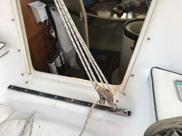

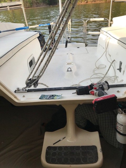

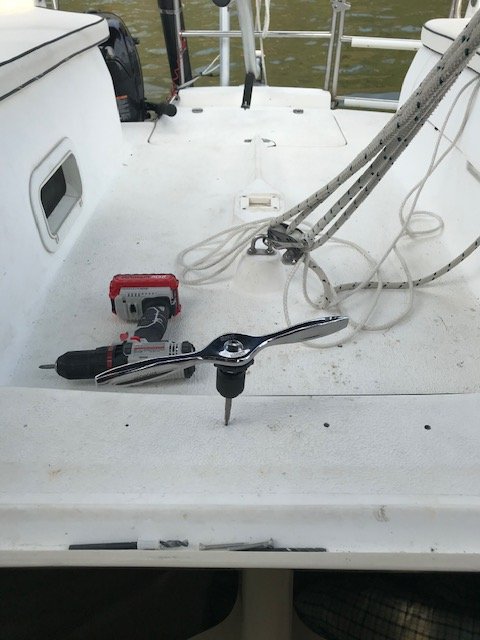

No but I can give you insight as to why not. I bought an H26 in 2015 and the H26 does not have a traveler. It also does not have genoa cars. The genoa block is rather inboard so the foresail always pinches the slot unless you are pointing high. And I found I was fighting the helm a lot...
So!!! I added a traveler. It is not high tech but now I love my boat even more...also did a reverse barber hauler type thing to ease out my genoa sheet
genoa sheet.
