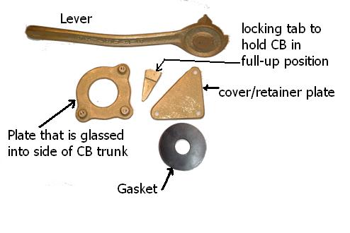

I have a DS 1 which uses a handle. The handles are cast metal and probably can't take much strain. Try removing handle and dropping centerboard out of the trunk for inspection. Boat should be on its side or up on sawhorses.
Jun 2, 2004
1,956
Oday Day Sailer Wareham, MA
There might be a little "pawl" that holds the CB up, (not all O'DAY boats with the lever-operated CBs had them). To lower CB, first move lever slightly forward, flip the pawl out of the way, then CB should lower. I have seen these pawls, but my old WIDGEON didn't have one, neither did my Dad's Beetle Falcon (near sister-ship to the O'DAY Osprey), so I understand the use, but have never used one.
One nice thing about these lever-operated CBs, removing the CB is easy; remove the 3 screws that hold the triangular plate in place, pull the lever out, and THUMP... the CB will drop out......well, it should, but might be wedged by dirt/fouling.
