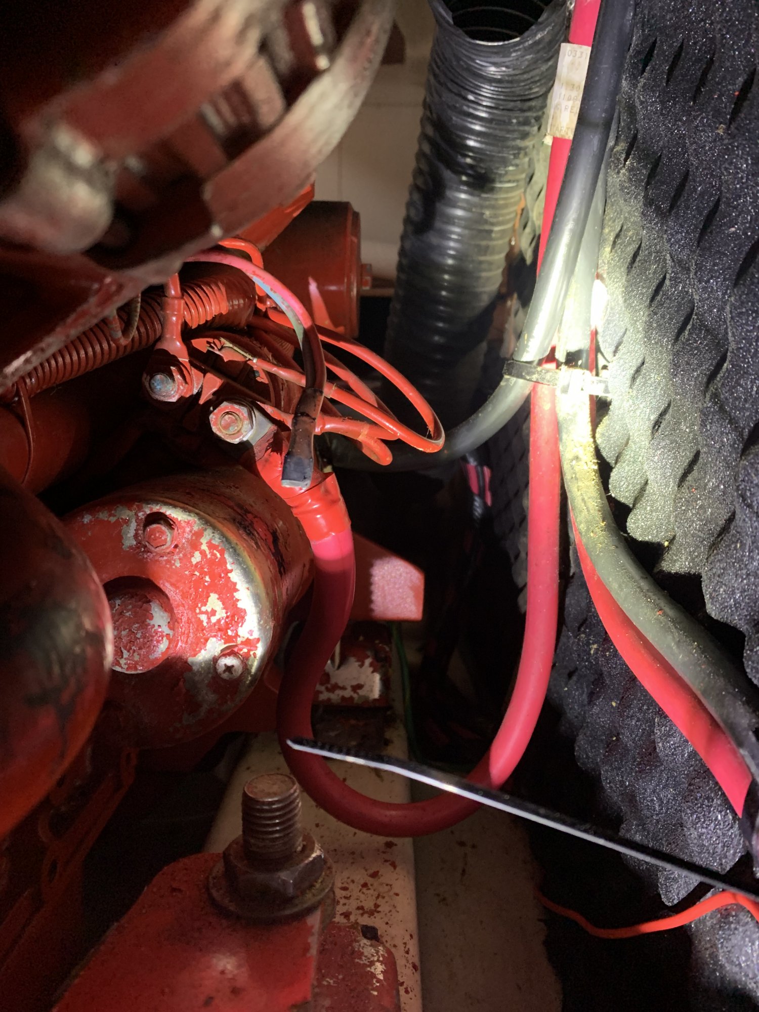

when trying to turn on my engine this weekend there was no power from ignition to starter but all other circuits were on.
When checking the starter I noticed a wire that had come loose and I decided to disconnect the +ve from the starter forgetting to turn off the main. It dropped onto the starter and sparks were flying. Now there is no power at all. I checked all fuses and they’re all ok. Does anyone have any suggestions what else to check?

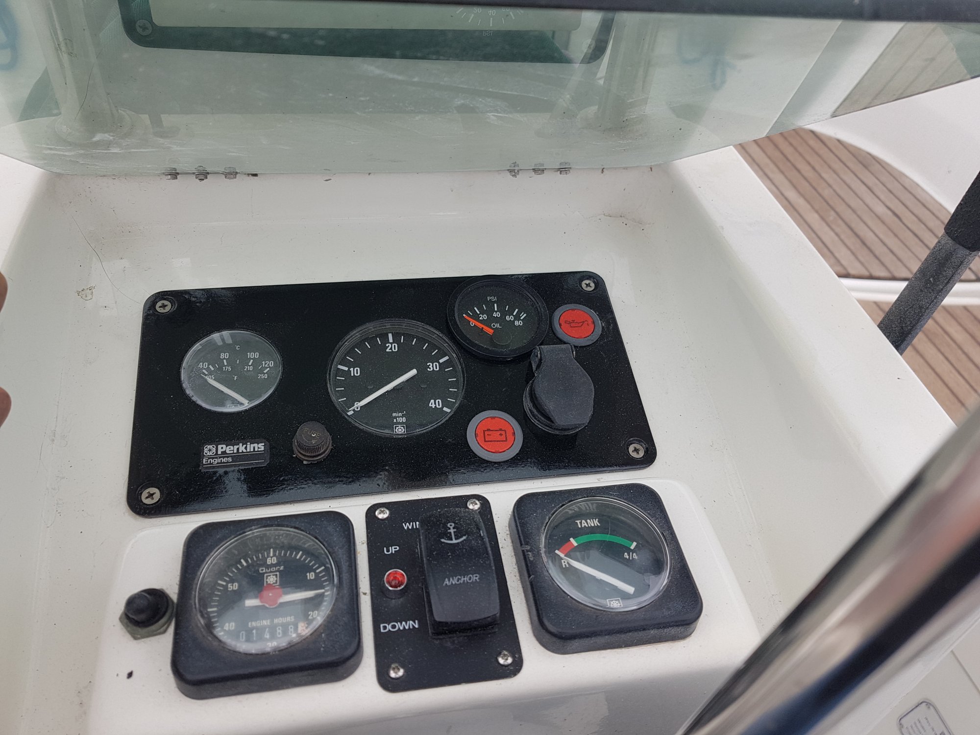

Check the red wire that sparked , a lot of OEM's use fusable links ,especially in high amps , it looks like part of the wire with shrink on it. My boat has a fuse at the start panel ,yours may be under panel. You can see fuse in pic under tach
