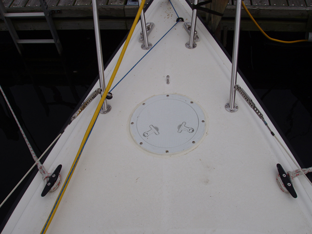

Use a bucket and deck hatch to make one
On a Macgregor 26S, there is no anchor rope locker. I used a 12 inch deck hatch and cut up a plastic bucket to fit over the flange. Seal it with 3M4200 to make it water tight. The bucket got inserted onto the foredeck and the deck hatch sealed with buytl tape. All you see underneath is about 1/2 of a bucket. A drain hose was connected on the bottom of the bucket to the overboard drain.
It holds 150ft of anchor rope. Simple and cheap. Got a lot of positive comments.

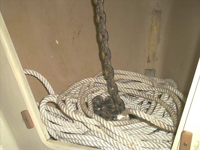

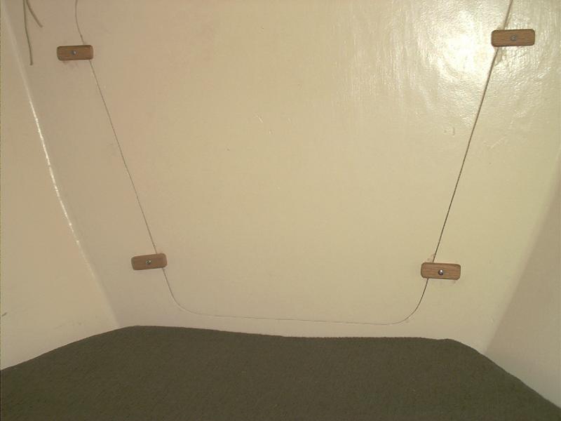

Mine was cut to fit, then used epoxy/woodflour fillets, and 4 inch glass tape to attach to the hull sides, sanded smooth, then painted.

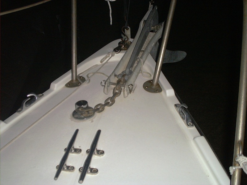

Here's the deck side, showing the deck pipe

Nice job!

Really nice job on the locker below decks TSBB.
I know what you mean, some boats comes with bargain basement plastic cleats.
I picked up a old bronze bit on ebay and replaced the single cleat on mine. It was heavy enough (1967 boat) but crowded with 2- 1/2" lines. I use the factory cowl vent for a deck pipe.
