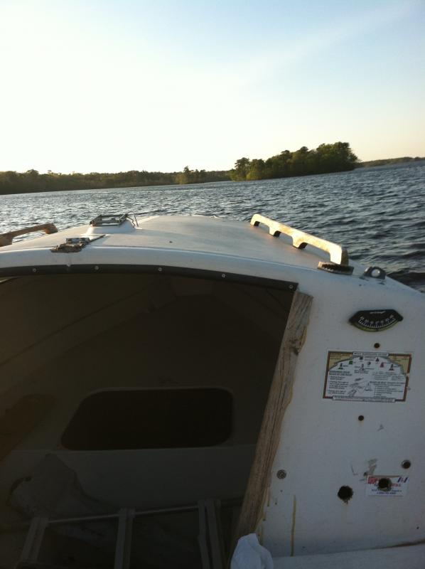

I took a close look at the motor mount plate. The plywood was delaminating and the bolts were rusted so I decided to build a new one. Glad I did, take a look at the first photo. Laminated some plywood together, epoxy coated it and installed it with new SS bolts.

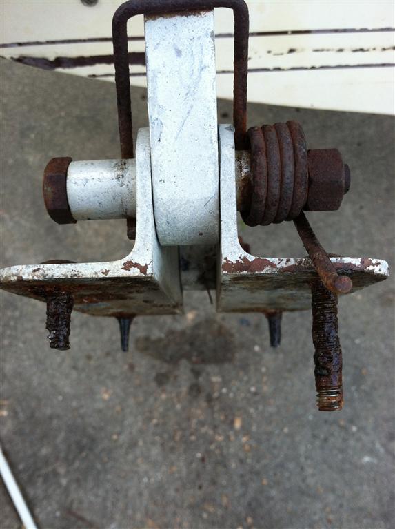

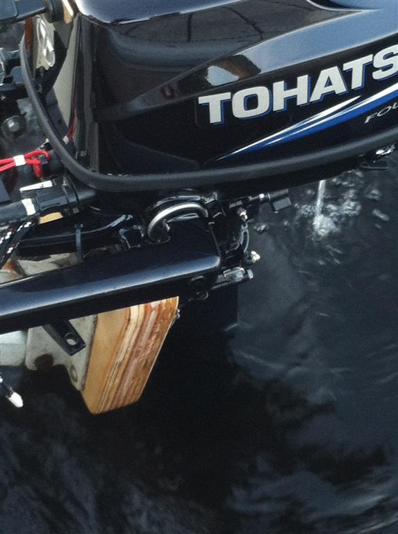

Then I decided to take it for a ride. No sails, wind was too gusty for first time solo sailing. I just motored around, getting use to the boat, docking with motor power and pushing winds, and getting it back on the trailer. I had a blast being on the water. Photo 2 shows how nice it was. Photo 3 shows how low the long shaft motor sits. Is this an issue?

Congratulations on starting the projects. From the look of the motor mount bolts they were way beyond due for some attention. The distance from the motor power head to the water might be fine. You'll discover how it rides as you get into some wave action. You probably can tilt the motor when you are sailing so the prop will at least nearly clear the water. My concern would be whether the power head gets dunked as the stern rises and falls in waves. At least you should not need to worry about cavitation under normal motoring conditions.

An idea for your motor: It looks very low to me, and even if you sail in protected waters, with that short of a hull you're gonna be pitching at some time or another. I had the same issue on our dinghy. What I did was to get a square section of wood (like a dowel only square) that was the same dimension as the thickness of the transom, in your case the depth of the new plywood you made for your bracket. Glue it onto the top of the bracket, which will raise your motor enough to get it into the right depth.
This works if you can't or don't have adequate intermediate "stops" on your bracket as you lower it.
You just need to get the motor a "tad" higher out of the water (for normal running as well as for following seas.
Is that clear enough? Any ?s, let me know, please.

2. engine height is a tad low, is the motor an extra long shaft,

Is the motor an extra long shaft (25 inches), long shaft (20 inches), or short shaft (15 inches) from mounting surface to bottom cavitation plate? If you don't have an extra long shaft the motor might need to be that low in the water to prevent cavitation- prop comming out of the water when you go forward or hit a boat wake. The trade off is that when you get following waves or a big wave on the bow you can dunk your motor, realy need an extra long shaft for that reason. There might be height adjustments on motor or mount for slight adjustment or like another said block it up where it mount on bracket.

Stu's idea is a good one. An alternative, if you have enough of that plywood left, is to cut a piece with a greater height. A single piece might be a little stronger than a glued on piece. Though with today's kinds of glue, shouldn't be a problem either way.

The motor is a long shaft and the bracket is either up or down, no middle settings. I like the idea of making a new plate that will put the motor a couple inches higher.
To seal the wooden bracket I used a forstner bit to drill over sized recess holes for the nuts, bolts and washer. I used one regular washer and one oversized washer. I did use the nylock SS nuts. I even counter sunk the holes on the other side and will use Miane Sail's butyl tap to as a sealant on both sides.
I should explain that I had done a lousy job on the first coat of epoxy so Iused it for that one day of motoring, than took it off and refinished it. Now it is ready to be put it back on but I think I will start on one that will put the motor higher.
