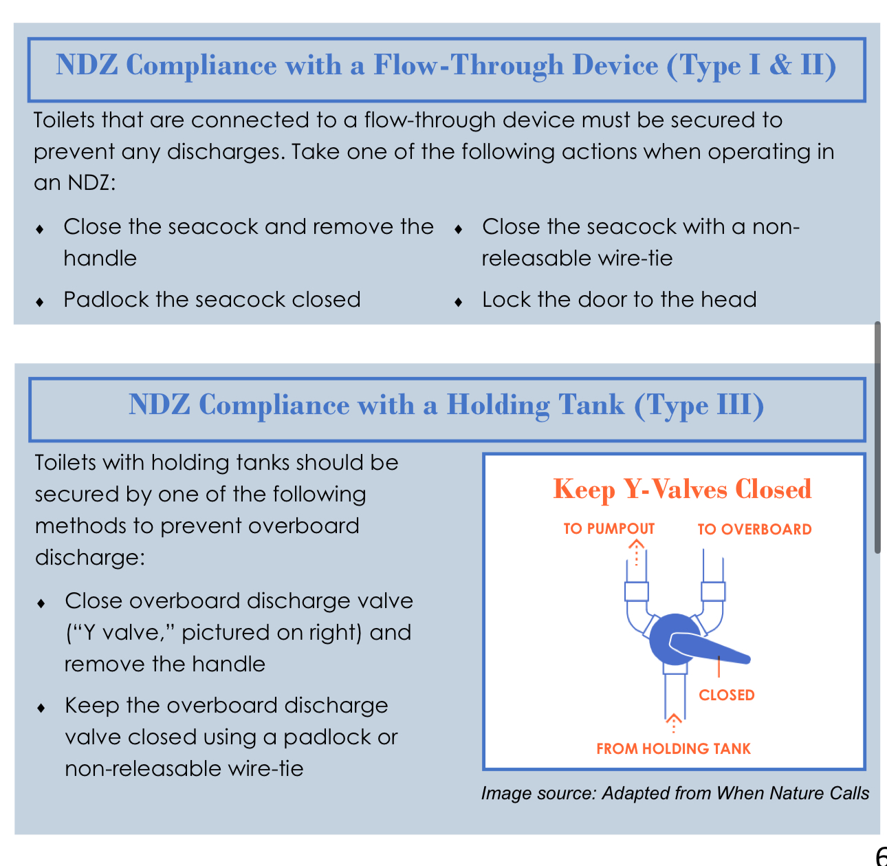

Ah. Upon closer reading, the “lock the door to the head“ only applies to type one and type two. But, yes, I’m bemused as to the required precautions, when simply within the 3 miles zone, but not specifically a NDZ. :what:

I am not at all bemused and think the precautions are appropriate. Of course as they say for locking your car or your house "Locks are for honest people." It seems the locks or zip ties are more to prevent honest people from inadvertently discharging waste overboard because of a mispositioned valve. The regulations prevent knowledgeable honest people from intentionally discharging waste where they are not allowed to discharge not the securing devices. Of course people who don't obey the rules can easily unlock the lock, put the handle back on, or cut the zip tie then discharge overboard and hope to not be caught (which is actually unlikely for the during the time of the discharge). Then they can put it back on. Just a fact of life. Locks are for honest people.
The ocean is a pretty big place and the 3 miles is very likely more that the regulators had to pick a distance and 3 miles is a convenient one and is used for other purposes. It is probably not based on exhaustive scientific research. Works for me though. They could have picked 12 miles too but I'm glad they used 3 miles not 12 miles

My boat did not have much room for a tank, I wound up building a custom fiberglass tank that sits above the water line on the starboard side, it is a tall skinny tank that fits behind my sink.
Works incredibly well how I have it setup, toilet pumps into the tank, there is a low point drain on the tank that goes to the through hull. You have to open 2 valves to send it overboard, one at the through hull, one at the tank, keeps things simple.
BTW a ziptie holding the valve closed will satisfiy USCG.

All composting toilets have a urine container. What you do with it or the composting side of it is up to your morals and the laws. With a composting toilet there is no need for a black water holding tank. When I had my traditional system, I had the seacock valve handle removed to the valve could not be opened. It was never inspected but I think it would be acceptable.
