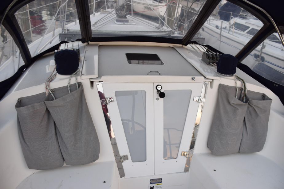

I shut it off and found this new bit of "character" added to my companionway hatch:
The burn goes through the textured gelcoat into the underlying glass. Yes, I was lucky that I didn't burn the whole boat down.
Any ideas of how I should proceed to improve the appearance of the companionway from here?
The boat is an O'day 35, and the companionway hatch was in great shape before this incident...
