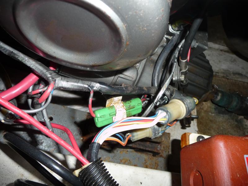

I agree, also check the connections and the fuse in the little plastic fuse case down close to the plug connector..
picture is what the little green case looks like on a 3 GMF .. very similar wiring
