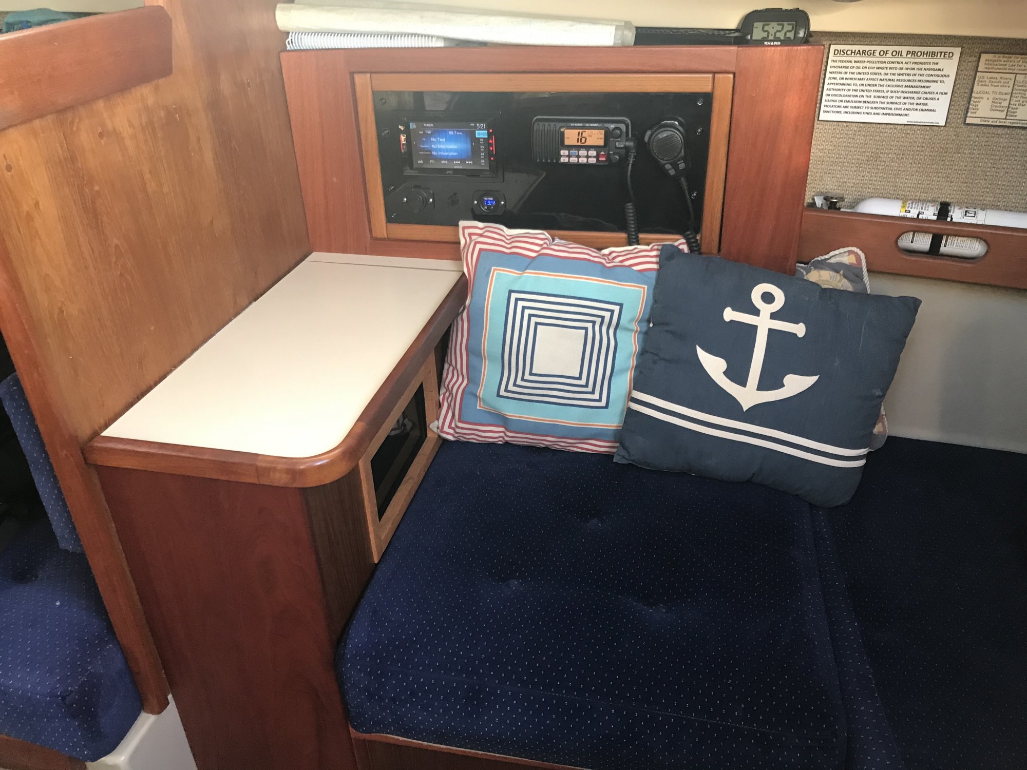

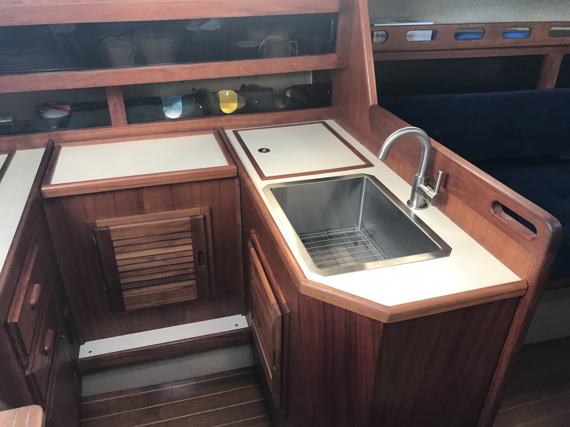

Here's what I replaced the galley and nav cabinets with - goals were to have one larger sink vs. the two small ones, cut off the corner at the galley so you don't have to turns sideways to enter. The top is matching formica, wood is teak plywood (cabinet grade) and mahogany. Nothing too fancy and it can all be taken apart (unlike the original which had inaccessible screws, once again). Right now, I have the stove out with a simple cabinet in its place. For the nav station, I didn't think the closet was of much use (mine had the backside of the electronics in it) and sitting at the nav table usualy resulted in bangng your head. I wanted to move the batteries there and open up the quater berth - there are two golf cart batteries in there now plus some good storage underneath the seat and a smaller nav desk with storage. I'm toying with what to do with the bulkhead. These pictures aren't that good, they look better in real-life.

Nice changes! Every season I think about changing to a one sink galley also...
